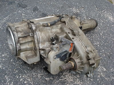

If the transfer case input shaft seal leaks, transmission fluid will enter the transfer case. If the vacuum switch leaks vacuum, fluid will be sucked into the HVAC & 4WD vacuum systems. As you can see in this image, the vacuum switch is nowhere near the top of the transfer case. Even when the transfer case fluid level is correct, the switch is very close to the fluid.
If the problem is not taken care of right away, the transmission fluid will deteriorate all of the rubber parts in the HVAC & 4WD systems: Vacuum lines, actuators, HVAC mode switch, etc. It all needs to be thoroughly cleaned out, or you'll have ongoing problems with both systems.

So considering my trans fluid hasnt made a, noticeable drop and the t-case seems to be a little low. Do you think its just a bad vac switch on the t-case and not the input shaft seal?

The clue to a leaky input shaft seal is low transmission fluid level, along with high transfer case fluid level. I think you can safely assume that the switch is the problem. You still need to clean out the two vacuum systems: actuators, lines, reservoir, HVAC mode switch etc.
