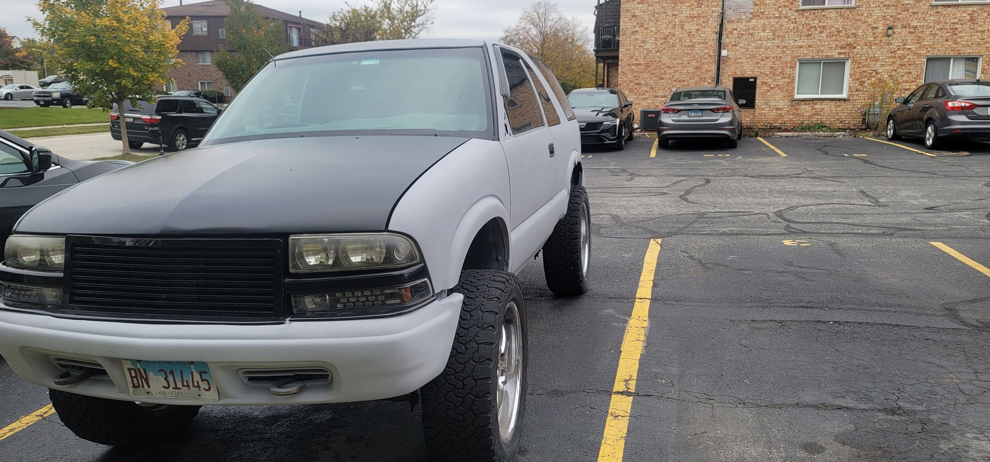

Can't help with the issue, hopefully it's and easy fix.
But not sure if you have a zr2... doesn't look like one... are there any marking on thw factory stickers of zr2? Or do you have the rpo code?

😐 yeah its a zr2... 100%... im not new bud 🤣🤣🤣 ive more or less completely rebuilt this mf from the ground up... i put sonoma fenders and bumper on it... it doesnt look like a zr2 by design, u know like on purpose... ive removed the swing gate and wiper hardware off the tailgate too... 🤷‍♂️ never judge a book by its cover

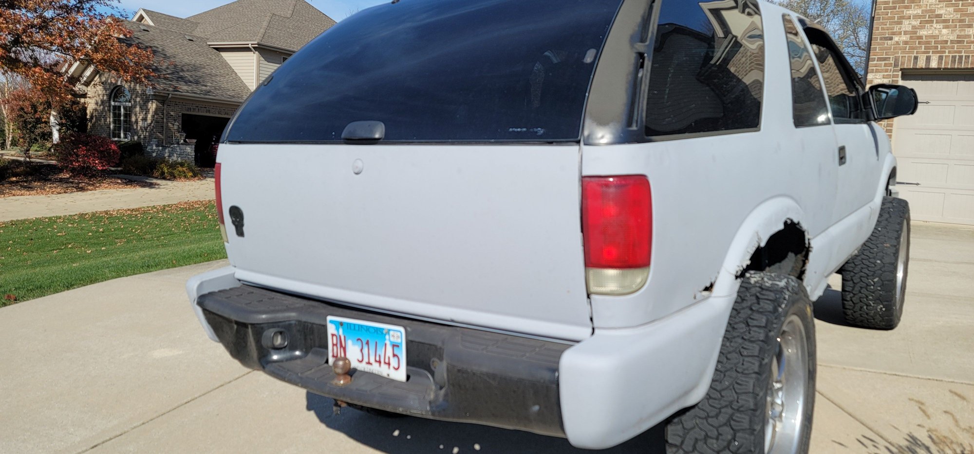

I just said that because you looked a little skinny in the rear from one pic... front fenders didn't have the extra lip of metal for the flare(could've rusted away), also didnt notice any holes around the rear wheel well for the flares neither(also couldve rusted away).
But glad you didn't get screwed like I've seen many have been... alot of people will post a lifted 2 door blazer as a zr2 just to get extra money selling...
