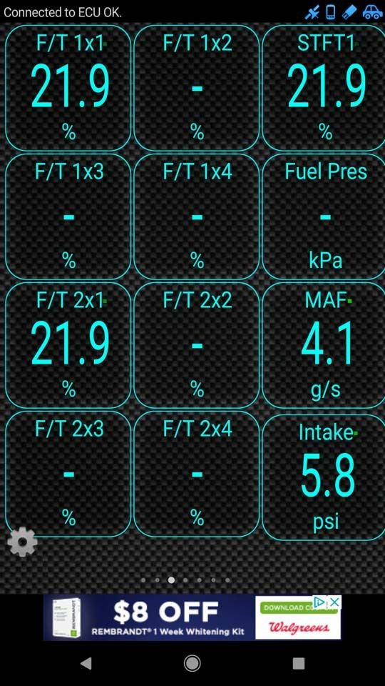

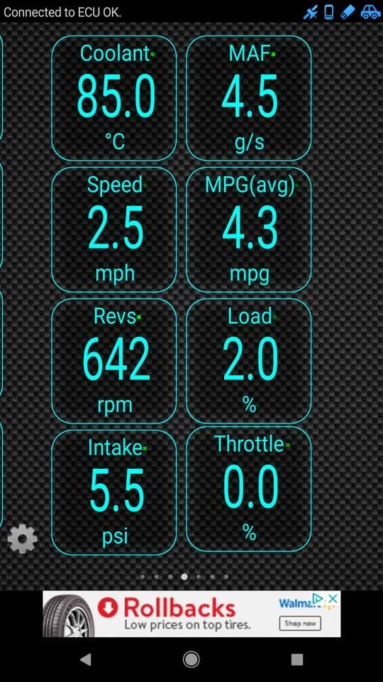

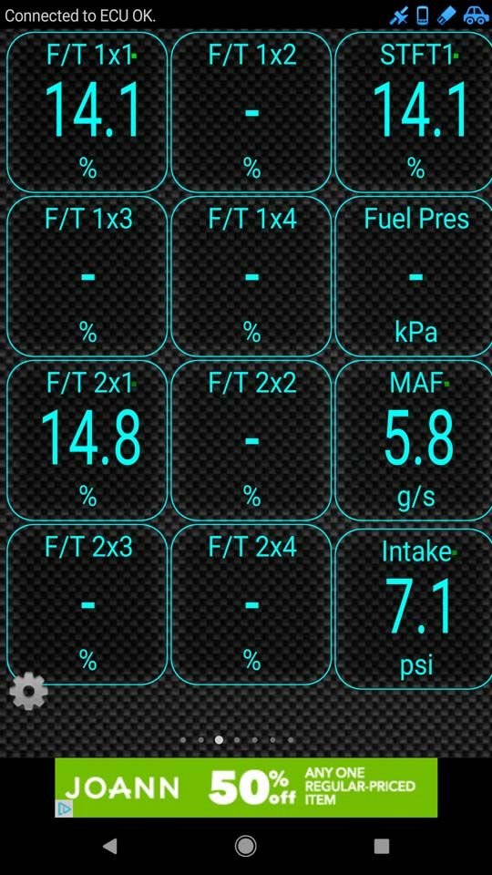

I was in a traffic jam the other day and I was able to get some live data fro fuel trim and my o2 sensors.
Stats at idel
While driving (don't remember what speed but I wasn't moving fast)

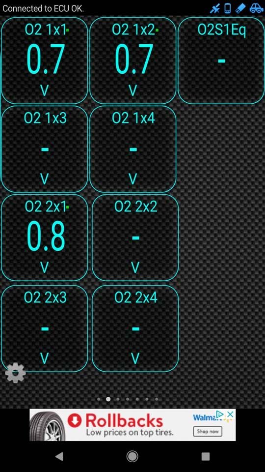

Then I have the readings for my o2 sensors. I don't remember when I captured these:

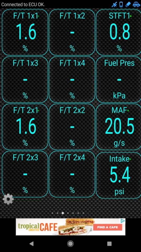

I also have this fuel trim reading that I don't remember when I capture it, but it seems really off
The thing that baffles me is that I'm not getting a reading form all my furl trim and o2 sensors. I don't know how many fuel trim sensors I should have. With the o2 sensors, I believe I have 4, but I'm only seeing 3 in my diagnosis being reported. I don't know if I have a malfunctioned 4th sensor or if the app on my phone isn't working right. I'm using Torque Lite with a OBDII bluetooth adapter and it doesn't always want to connect to the ECU. In fact, while driving, the live data completely freezes and I have to eject the ODBII adapter and reconnected it, but the graphs and display on the app always freeze again. I'm surprised it stayed working all through the traffic jam when I was running this.

You have three O2 sensors. One on each bank before the cat. Bank 1 sensor 1 is drivers side (#1 cylinder) and B2S1 is pass side. After the cat is either B1S2 or B1S3, that changed during the 2002 model year.
There are 4 fuel trims. STFT and LTFT for each bank. You add the STFT and LTFT together for a given bank being mindfull of sign (+/-). Single digits is good, double digits is trouble, >25 sets a code (absolute values).
Your MAF values look low. I'm with visiting family today but look for a rough idle thread where Les and I compared values.
