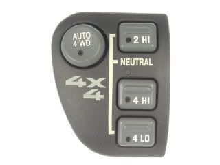

If ya really think its the Switch (which I doubt), I have one that I will ship to you for the cost of shipping through PayPal. It is brand new in the blister pack from Help!/Dorman and looks as pictured below. I have no need for it just give me your zip for shipping price. lower 48 only.
