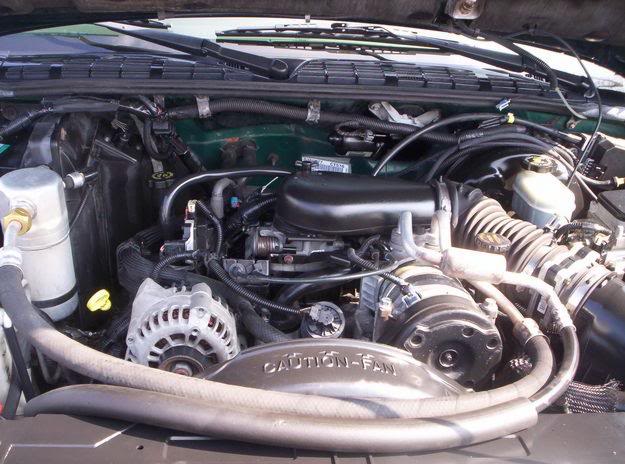

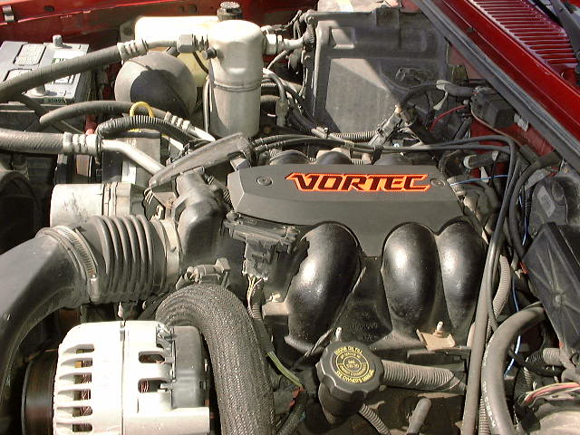

Two different fuel delivery systems were used in 1995, two different sets of diagnostics & specs. Which engine do you have?
This is CMFI:
This is CSFI:

Thanks for the reminder captain, I always forget 95 was a transition year.
Old Jun 12, 2012 | 07:24 PM
Captain Hook's Avatar
Joined: Mar 2009
Posts: 8,453
From: Belleville, Michigan
No problem, I need reminders sometimes too That one's easy for me to remember: there were 2 different fuel delivery systems, and 3 different OBD systems used in 1995 S&T vehicles. Too much "mickey mouse" for Olds to deal with so they didn't produce the Bravada in 1995.
