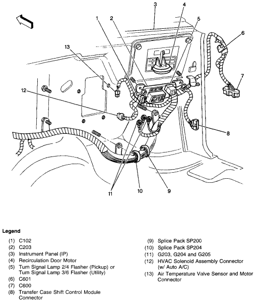

Hey guys.. something tells me some of you may have grounding problems:
Look at these two pics..Click this pic to help locate the Ground points G 203, 204, 205 which come off that fat bundle
They ground the body control module circuits.
This attach below shows the other IP wiring harness for reference. Arrows in each point to front

Ill try to check it out but feel a little over my head when it comes to the electrical aspect of these vehicles, simple stuff i can handle, mechanical stuff i can mostly handle too. thanks for the diagram that will help
