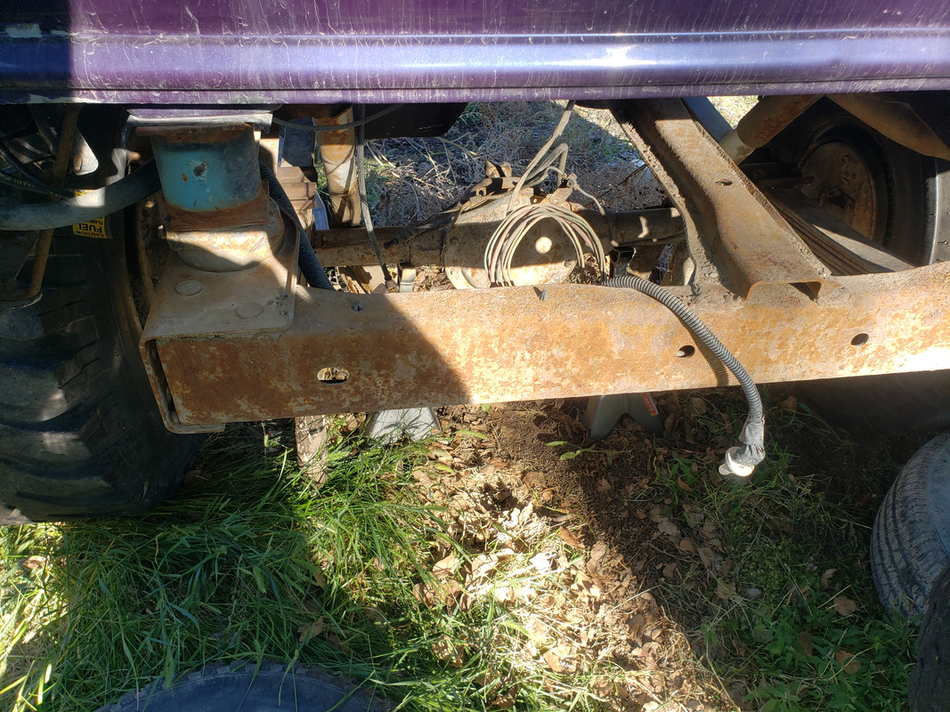

All of the rear light wiring is behind the bumper. Hope this helps

It does thank you
