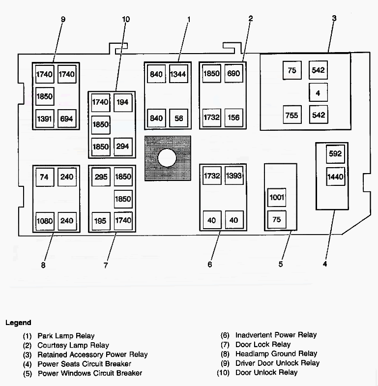

It is wired up a bit differently, depending on if you have 6 way or 8 way seats - and if it has memory seat function. But for all cases there is a circuit breaker in the body relay block for power seats. This circuit breaker feeds the big orange wire that goes to the seat switches, and then to the forward/back seat motors. (Lumbar can be on a different circuit.) This big orange wire should have 12V on it at all times or you will not have forward/rear/up/down working on driver's seat.
If there is 12 V to the seat switches, then you have isolated the problem to theand will need to be not then (Ignore the yellow text in the photo below showing the location of the body relay block).
switches, motors, or connectors at the seat. If it does not have 12V going to the seat switches, then that is the problem
Ignore the yellow text in the photo below showing the location of the body relay block. I pulled it from an unrelated source.
This starts the analytical approach which I was going to wait on depending on the OP’s answer to my last post. If he decides to go this route then Les will guide him well.
