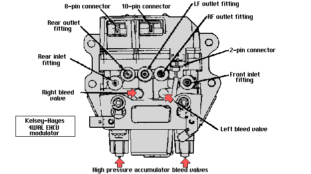

Brake line from front to back rusted out, ended up breaking all front brake lines while replacing. before removing the threee brake lines from the ABS unit I labeled them with duct tape and pen but it rubbed off sometime during bending new tubes.
Going from windsheild I need to know which one goes where... I have one line that goes to passenger front, one line that goes to driver front and one goes to the Intermediate line which runs from front to back.
does it matter which abs port each line goes into?
I realize this question is harder to articulate than I thought let me know if you need clarification...

Here you go
