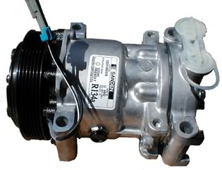

If the front seal is leaking, it needs to be replaced. Here's something to consider though: Your 2000 originally came with a Harrison HT6 compressor. They are very well known for leaking where the case halves join together. This is affectionately called a "belly leak". New or rebuilt, eventually they will leak. Sanden makes a direct fit, bolt on replacement compressor that is designed differently, and works extremely well. With one problem for sure, and possibly another more serious problem lurking, it might be worth replacing your compressor rather than repair it.

Yes that is why I replaced the compressor in the first place because the "belly leak". What a crappy design😛 Do you happen to know what auto parts store carries th Sanden compressor? Is it a solid case instead of the two piece design? If it's just one solid case I'll definitely get that one so I don't have that problem. Since I'm doing that I'll replace the orfice tube as I do not want to take any chances ruining the new compressor. I talked to a tech and he said since the dryer is new and I won't have to replace that since the system will not be open long.... 😕 dunno about that those aren't expensive so I may get one of those as well. Thank you again for your help Hook.

Sanden model #4440. You can check with auto parts stores locally or online.
