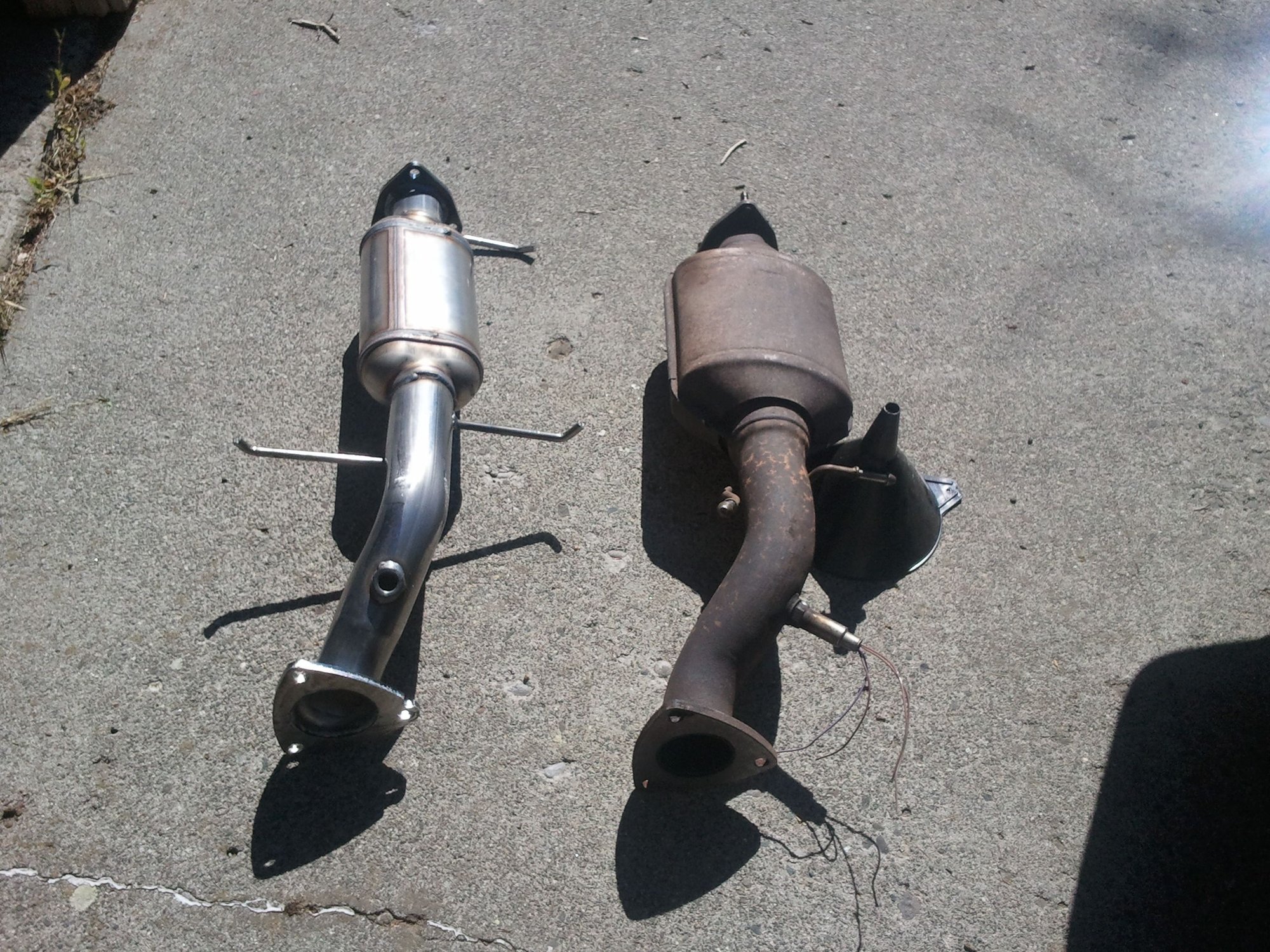

I purchased a catalytic converter for my 1999 4dr, 4wd Blazer. When I did a trial fit of the part I found that the bung for the O2 sensor was in the wrong place, on the top-side of the pipe so that when the sensor is installed, the sensor would hit the underside of the body preventing the converter from being mounted. The proper design is to have the bung situation so that it at the side. (See pictures below)

Underside of cats; new on left, old on right. Note how the O2 sensor needs to come out of the pipe to the side.
Muffler end view showing the incorrect placement of the bung for the O2 sensor on the new cat converter (on left).
Top view of converters showing the incorrect placement of the bung for the O2 sensor on the Ultra Exhaust converter that would prevent the converter from being installed if the O2 sensor were in place.

Because of constraints on my end, I went ahead and had it modified. I found a oil pan drain for the one hole and had an exhaust shop install a new bung for me in approximately the right location. It is not quite were I wanted it but we'll see when it cools off enough for me to install it. (100'F+ here today.)

I would plug the top bung and then drill a hole and weld in a new one

Yeah, that s what I had done yesterday. Will install it this evening or tomorrow. The extra cost was about $80. Grrrr.
