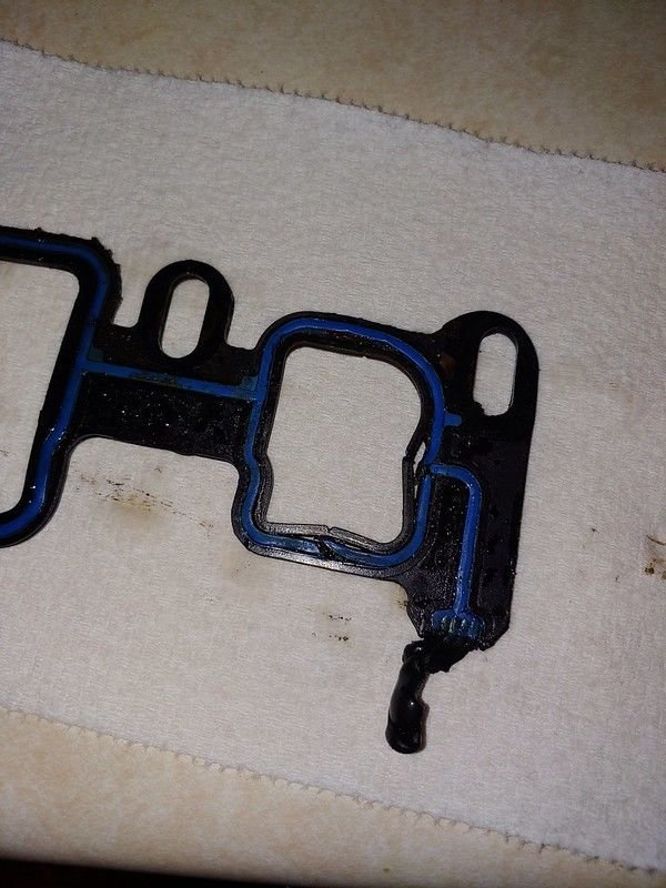

It was a harbor freight Torque wrench that is just not working (my mistake was trusting a harbor freight torque wrency). According to the documentation it is a click type. I am returning it and renting one from the Autozone across from my office.

The photos show your care in not getting stuff into where it doesn't belong. Kudos to you! See how much junk gets in those bolt holes (second pic)?
The squashed gaskets can happen from overtightening plastic ones - but not so likely to happen with the metal/rubber gaskets.
IIRC mine was a cheapo inch.lb wrench from Summit. https://www.summitracing.com/parts/wmr-m201/overview/
The Harbor Freight one https://www.harborfreight.com/14-in-...+torque+wrench
Similar but not the same torque wrench. Nevertheless, I'm sure they are both manufactured overseas.

I can't believe the junk that came out if those bolt holes when I tapped them. I got a nicer rental torque wrench from Autozone so I will retorque them tonight. i will also Declan and reapply thread sealer

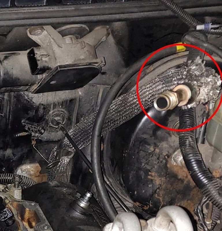

I just noticed that I messed up my EGR tube that goes from the exhaust to the intake manifold
You can't really see it here but instead of turning the end I was actually twisting it, so know it is a twisted mess. If I can't, how bad would it be to just block the ends off until I can get one from the local salvage yard?
That must be super soft because it twisted very easily..
Ouch! Will be very difficult to get the other end out of the driver's side exhaust manifold without heat from a torch and having the engine out. I would be tempted to try to repair the twisted section with a double compression fitting. Might have to go to McMaster-Carr for something this big, though.
Here you go (see attachments). If tube is either 3/4" or 1" and you have enough good tube length, then you could possibly repair it with one of the compression unions I have highlighted in blue. Tubing OD needs to be exact.
