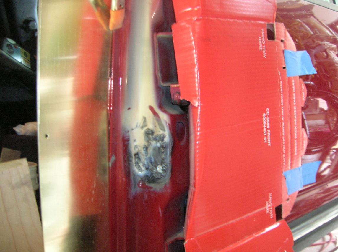

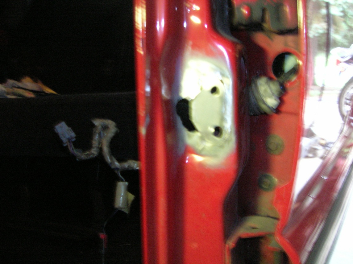

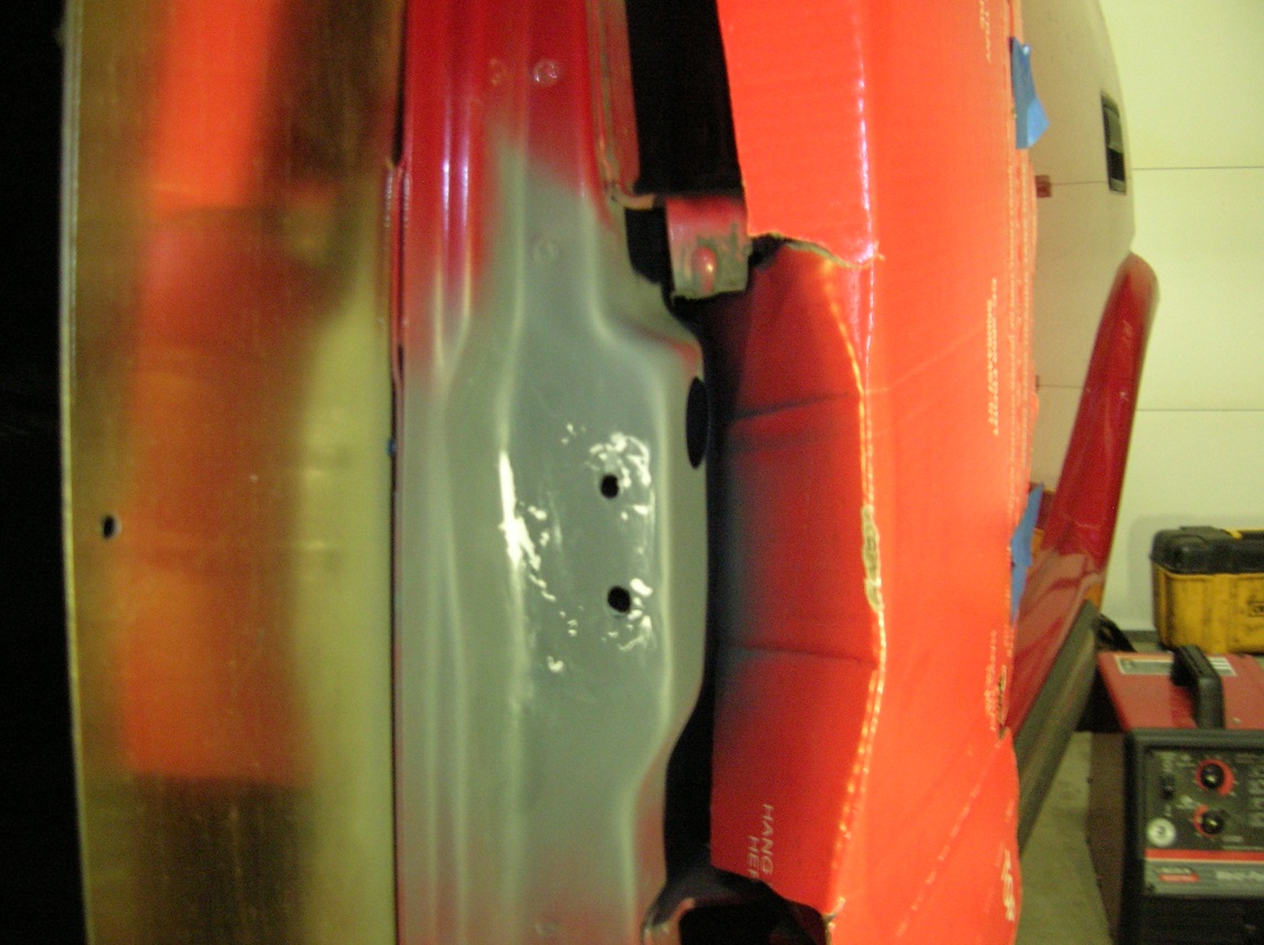

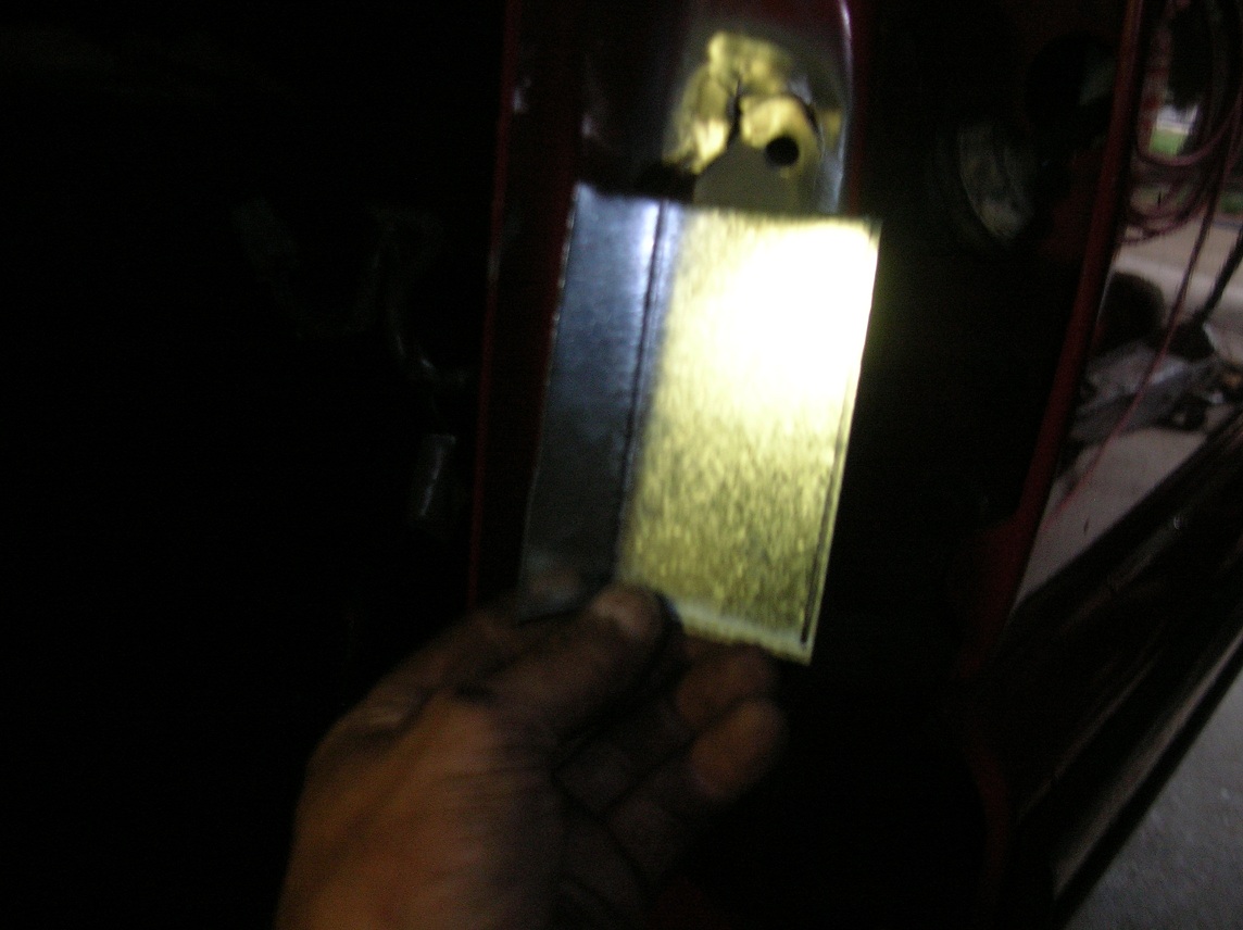

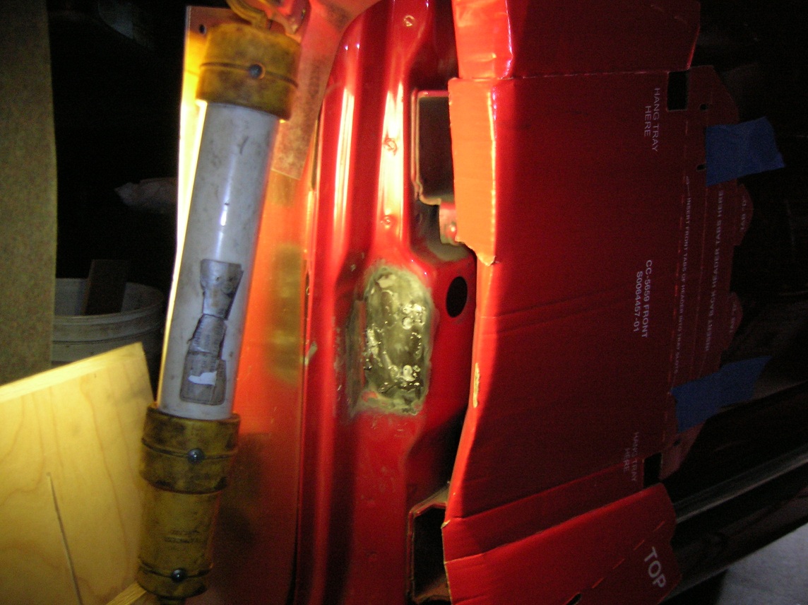

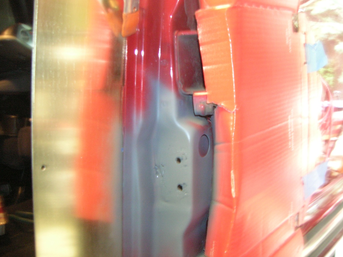

So the front door was rattling, took off the trim, seat belt, and striker.
Cut some heavy gauge sheet metal and bent. Secured in place from behind with wood blocks locked in place with tapered shims. Welded in place, and put out burning shims. Removed blocking and welded all cracks, making sure I penetrated through to the patch. Grinded down excess weld. then grinded some more. Till it looked almost like original. Primed, filled imperfections with caulk, and painted. Pictures don't show it but I also cleaned up weld, primed and painted inside the pillar. Waiting for paint to dry to re-assemble.
excellent job! this is about how i plan to do mine. deffinatly want to add thicker metal i think. im thinking about just welding large fender washers in behind it.
Looks nice, but be sure to finish the job with new hinge pins and bushings.

how thick was that metal u used? i got me a piece of 3/16" cut and ready to weld behind the pilar before i weld up the cracks.

10-78 edac is on a distinguished road
16 gauge duct metal. Locked it in place with wood blocks and shims, made sure I got good penetration on the weld. Gray primer and Duplicolor spray paint. And yes, installed new pins and bushings.

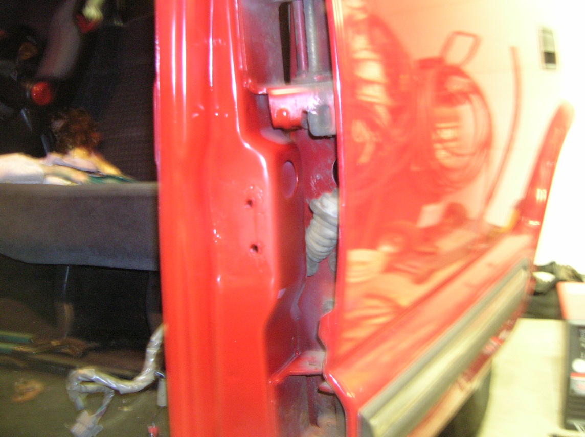

Default My repair yesterday
yesterday I decided to finally attempt a repair on my 1999 blazer with this same issue, here are the before and after pics. I used 1/8" stainless steel I had on hand and this area is now far stronger than the original area ever was. Replaced hinge pins and bushings as well and my door now functions better than it ever has in the 7 years that I've owned the truck.
