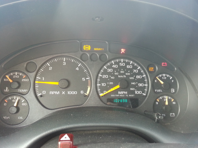

Hey guys I usually frown upon new members that have their first post as a problem on other forums im a member on but after browsing around I boaght this zr2. I knew it needed a few little things like a parking brake adjustment and tires, but right after I bought the thing I started having issues.
1st: 2 miles away from buying it I stop to get a drink and when I hop back in the truck I turned the key with no starter kicking on. All the dash lights were working perfect and shutting off in the start position as they should, but no turning over. Ignition switch? Turned the key about 5 times until she fired up. 2 hours down the road I stopped to use the restroom and the same thing.
Now just two days later, about half the time I have to turn the key about mulitple times sometimes like 10+ for it to turn over. Also lots of dash lights light up sometimes right after starting, sometimes going down the road, sometimes they will turn off going down the road. Other times it has no dash lights.
Its almost like the truck doesnt realize that its running but it is. I feel like it is either the ignition switch or the computer(I know its usually the scapegoat), if you guys could help me verify this or add in ideas it would help me greatly thanks.
