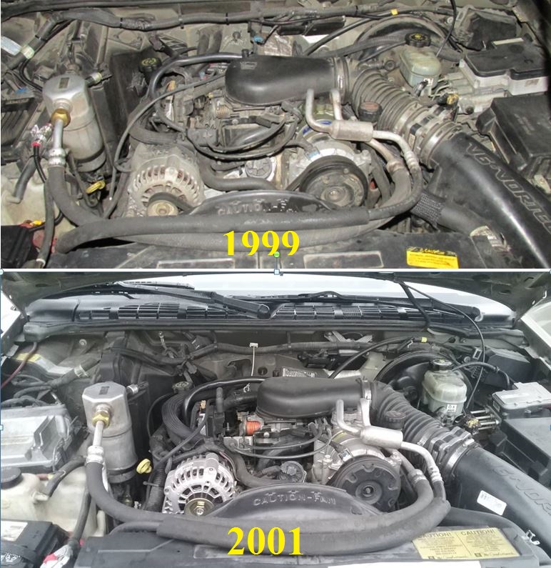

Old Feb 1, 2017 | 07:36 PM
  #47
cdtek101's Avatar
Joined: Jun 2016
Posts: 206
From: LAS VEGAS, NV
cdtek101 is on a distinguished road
I got the 2001 Donor Blazer for $600.00
Come to find out he had a guy drop a engine
in from another blazer...so really don't know
what year this motor is until we pull it.
It did run and drive good except for the
brakes...there were none hardly..nail biting
drive to my mechanics shop....but oil pressure
was just over 40psi at idol, motor sounds good.
Is there a number on the block to get more info
from ?
Below is a pic of my engine and donor, it's got
some new parts on it I may be able to use.

Old Feb 1, 2017 | 09:17 PM
  #48
LesMyer's Avatar
Joined: Oct 2014
Posts: 4,347
From: North Central Indiana
from ?
On block right at parting line between head and block at front of passenger cylinder head.

Old Feb 2, 2017 | 08:00 AM
  #50
LesMyer's Avatar
Joined: Oct 2014
Posts: 4,347
Actually here is additional info: The three letter suffix in the code at the front of the passenger cylinder head (from last post) is not as revealing as on small block Chevys because as far as I know no one has really correlated the suffix codes with specific engines and cataloged them in a list.
The vehicle identification number (VIN) for the engine should be on a pad on the left side rear of the engine block where mates to transmission and is typically a nine digit number stamped or laser-etched onto the engine at the vehicle assembly plant.
•The first digit identifies the division.
•The second digit identifies the model year.
•The third digit identifies the assembly plant.
•The fourth through ninth digits are the last six digits of the vehicle's VIN.
Also of interest could be the typically 6-9 digit block casting number usually found cast into the block somewhere just in front of the transmission mating surface. The list below deals with the last three digits of the number and groups according to year range and block type.
