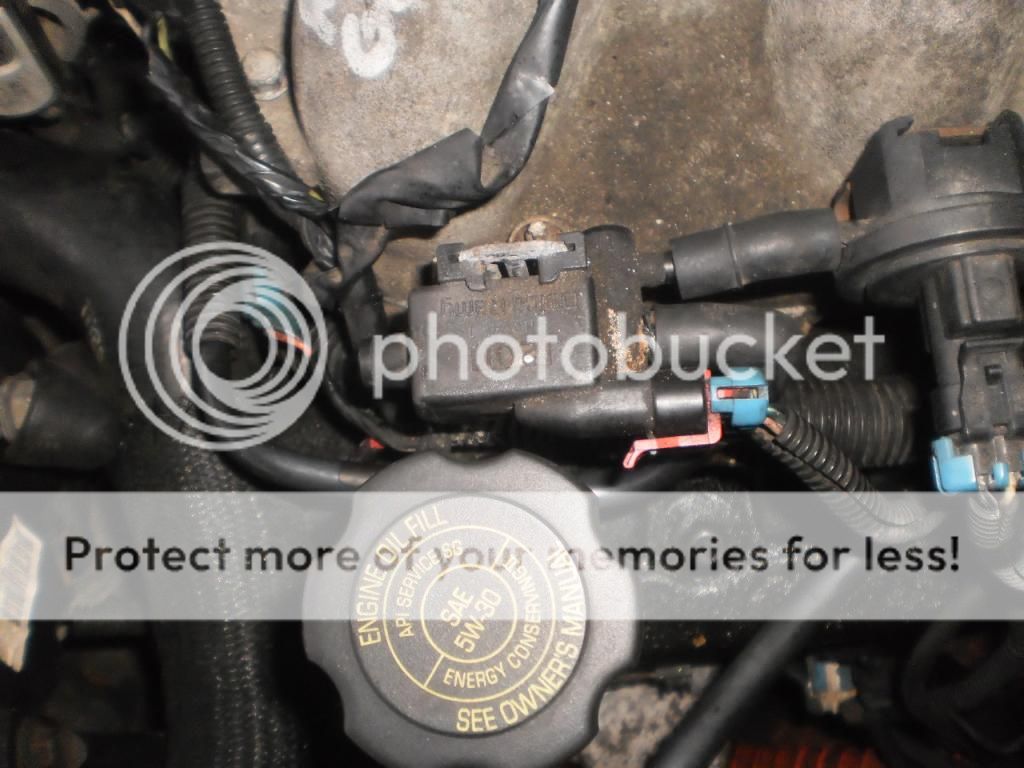

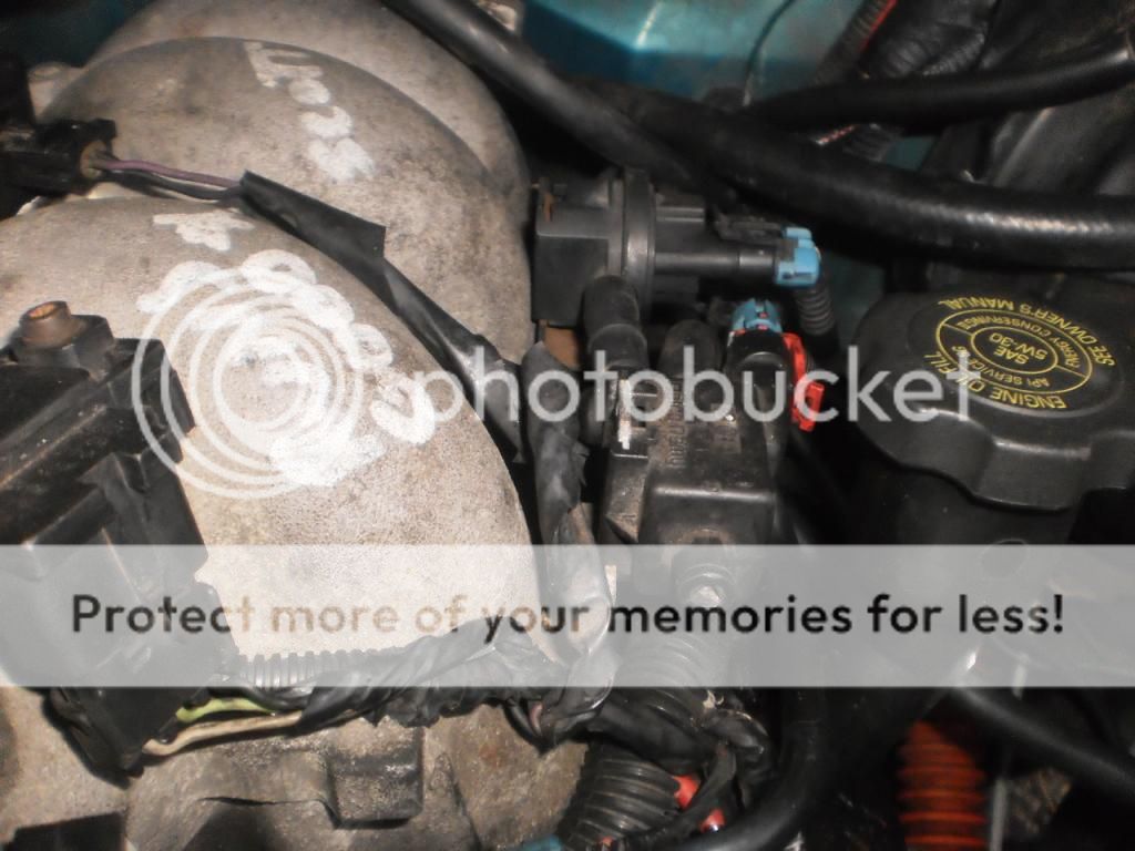

http://i1078.photobucket.com/albums/...ps45880f39.jpg
http://i1078.photobucket.com/albums/...ps4f6c69af.jpg I think you have them reversed. The round one for leaded gas is closest to the back {winshield}. Mine only have two vac ports each.
If you have them correct and still getting a code someone might have snapped the front vent line on your gas tank when the fuel pump was done, that's if you have a four door.
What I have is DOH syndrome in my descrption.
I have teh exact setup as your picture-i just described them wrong-thanks.
so, my back one is 1 in/out, the front one is 3 in. both with electric connectors.
I have replaced the rear one with brand new part. still the 1442 code.
repaired wires for better conenction at rear switch... still same code.
so on your rear one right under elect conenctor is there a vac nipple hanging down?
