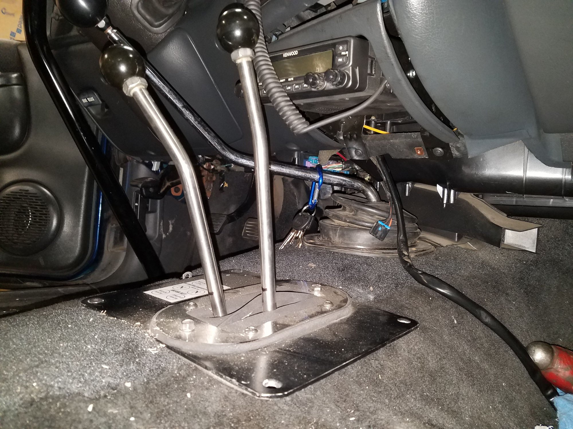

There's nothing wrong with using full-size truck parts, but you might need to use the transfer case out of the full-size, too. You're probably thinking of the old-school SM465 4-speed, which will still work but require a little more creativity. The newer 1/2-ton 5-speeds are no problem. It would still be best to get a donor with a 4.3, though, so you can use the flywheel and hydraulic parts.
This is what the shifter looks like with an SM465 (after slight modification).

And Tom A....hey nice radio....I have the same exact one in my Blazer.
Thanks. It's a lot smarter than I am, so I don't really use it for even half of what it can do, but it sure beats the old CB for trail communication. BTW, I wasn't quite finished installing it yet when I took that picture. It looks nicer now.
