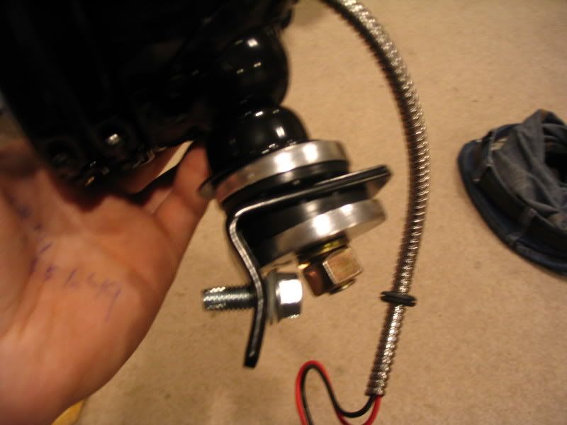

The lights themselves are too big, the mounting on the lights going onto the L bracket are behing the 2 bars, the problem is the light itself doesn't fit between the bars. I just took a quick measurement outside in the dark, in the freezing cold, and I measured aprox. 5.5 inches of space.

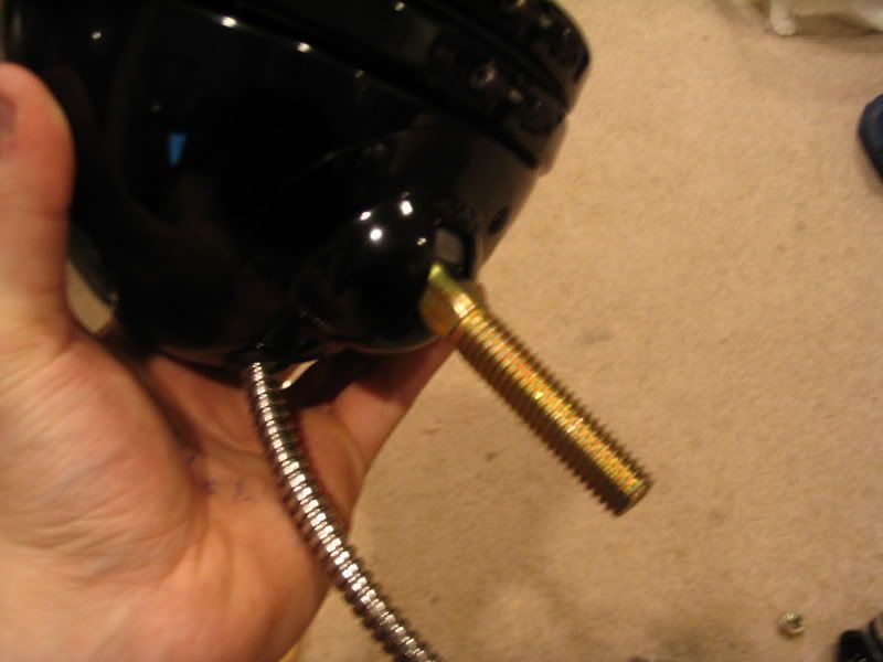

This is the mounting screw alone, it's about 2 3/4" long.
http://img.photobucket.com/albums/v6...lahblah120.jpg

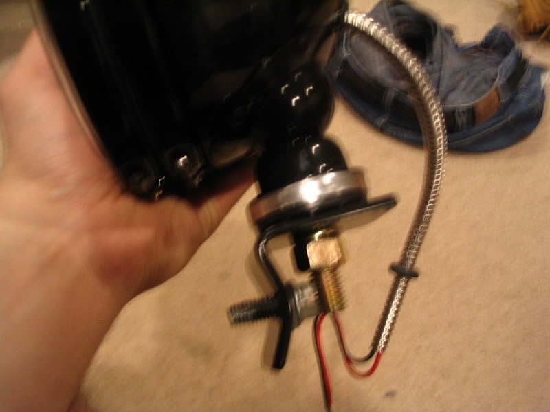

Now with all of the nuts and shock absorbers
http://img.photobucket.com/albums/v6...nik6/full2.jpg

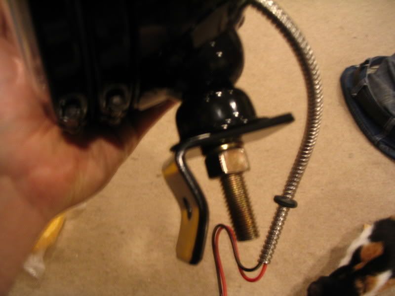

As you can see, the L-bracket is too small in the first place. Doesn't even fit. And the nut that holds the mount on doesn't even clear the bolt that attaches the mount to the bar. So, that's one big giant mess.
http://img.photobucket.com/albums/v6...lahblah122.jpg
