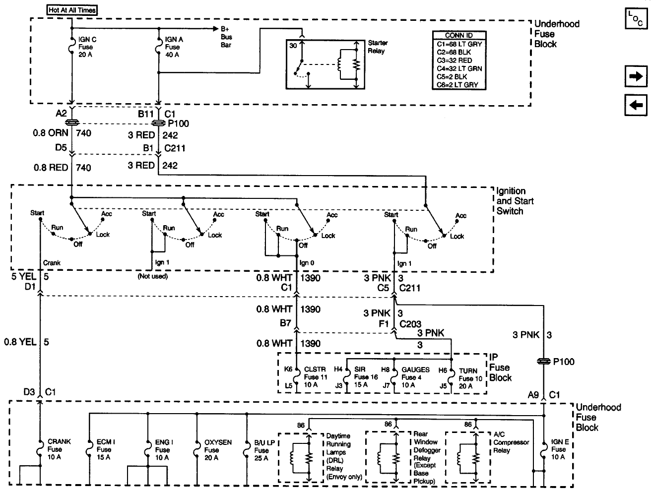

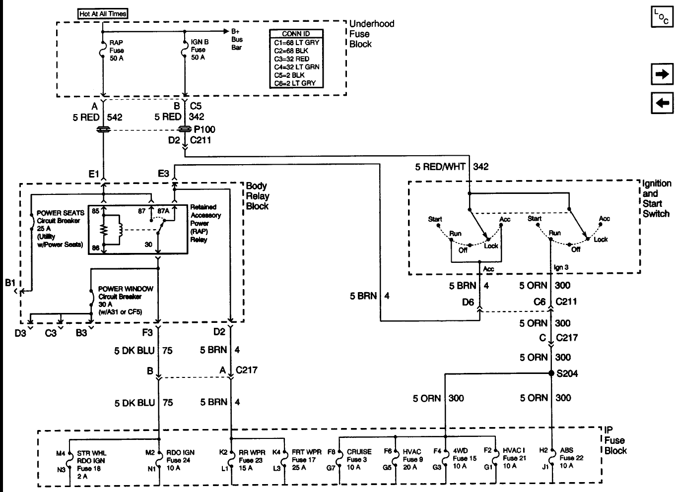

Old Aug 11, 2008 | 06:55 AM
Posts: 41,345
Default RE: Fuel and Temp gauge inoperative
You can functionally test the wires referenced in the images below:
