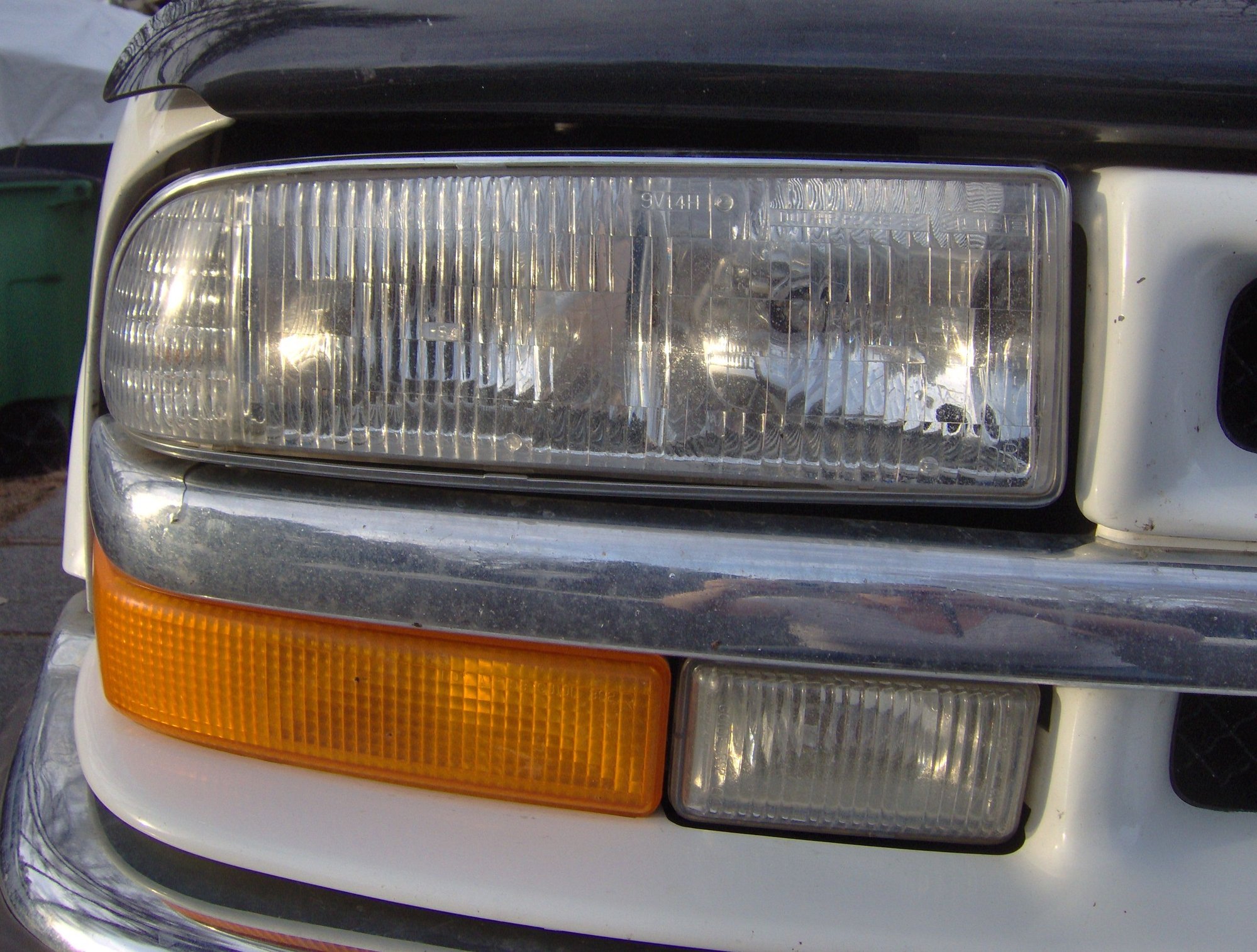

Mine after doing them about a month ago with the 15$ 3m kit from W-mart.
I did the lower marker lights and rear tail too
Came out ok, I figure good for a year or so.
