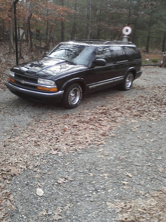

I have a 1995 3000gt and my friend has a 2004 blazer LS 2wd that he has built a motor for and wants to trade for my car. The blazer is in good condition and has a cowl hood. The bottom end of the motor is a non vortec 4.3 from an older s10 truck that was carbureted. It is rebuilt with the 2004 vortec heads on it. The crankshaft and rods are stock but has .125 dome pistons (i think 10:1 compression). The motor is bored over .30 i believe, and has roller lifters with a roller cam. The blazer will crank up and runs good when its cold (check engine light is on) but no knocks. but when it warms up the ecu retards the timing and makes the motor start knocking. And when the motor is shut off it will not crank back until its cooled back down and the battery has to be disconnected. Oh and its got the stock 700r4 tranny.

that picture makes the blazer look hella long, rims look nice on it tho

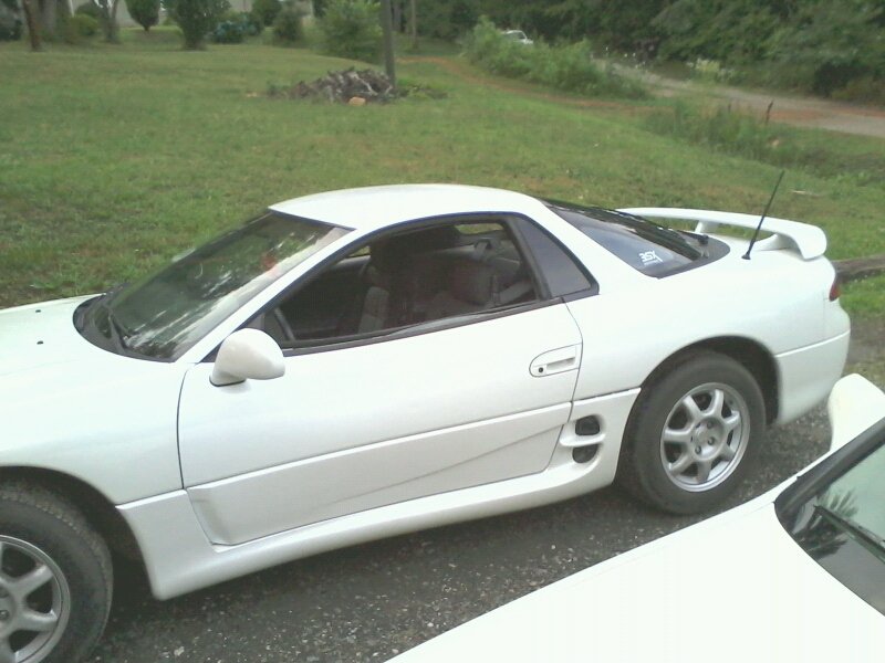

my 3000gt isnt exactly in pristine condition. Its been hit on the other side and could use some body work, and paint. The blazer is a nicer vehicle. And the 3000gt isnt my daily driver, i have a toyota daily driver.
