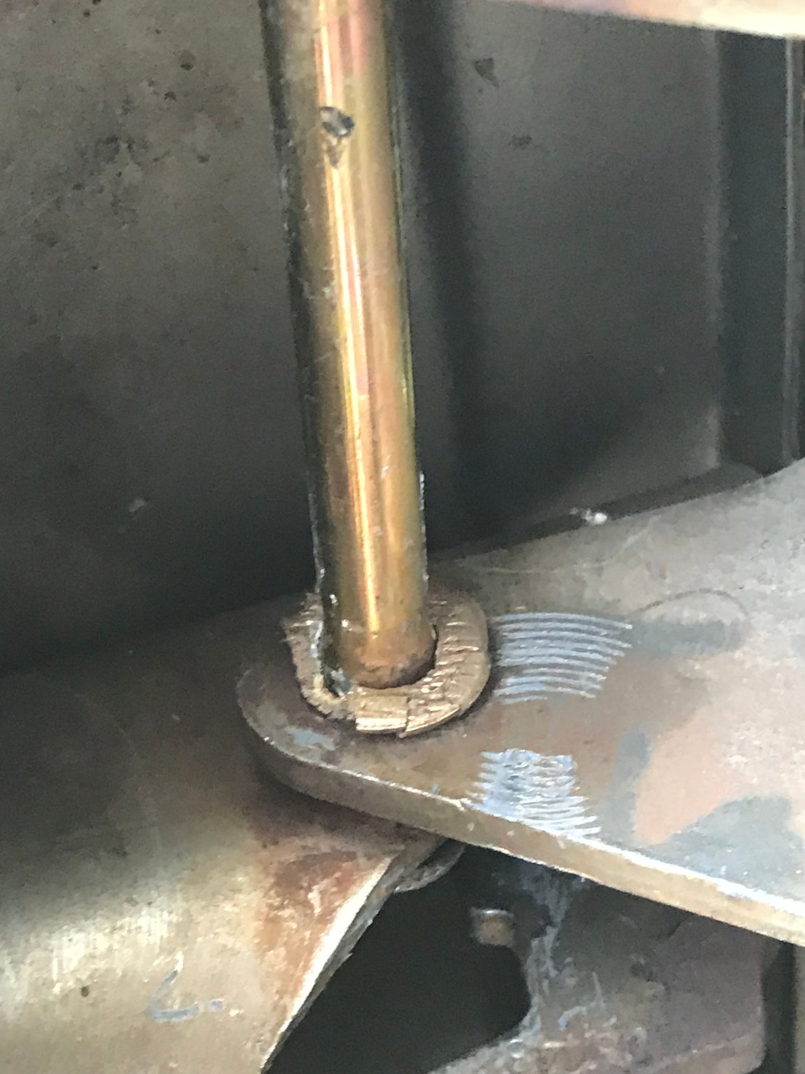

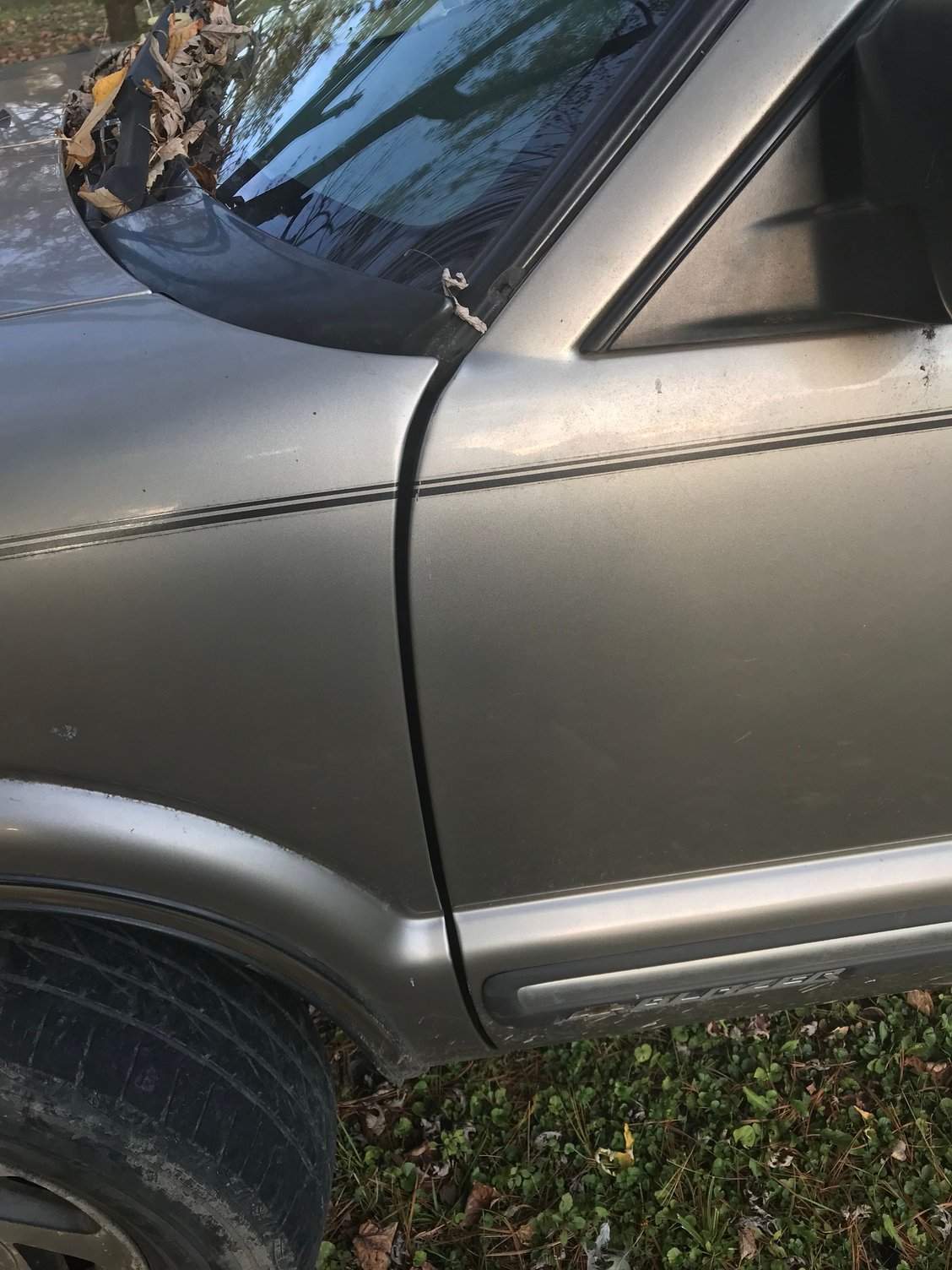

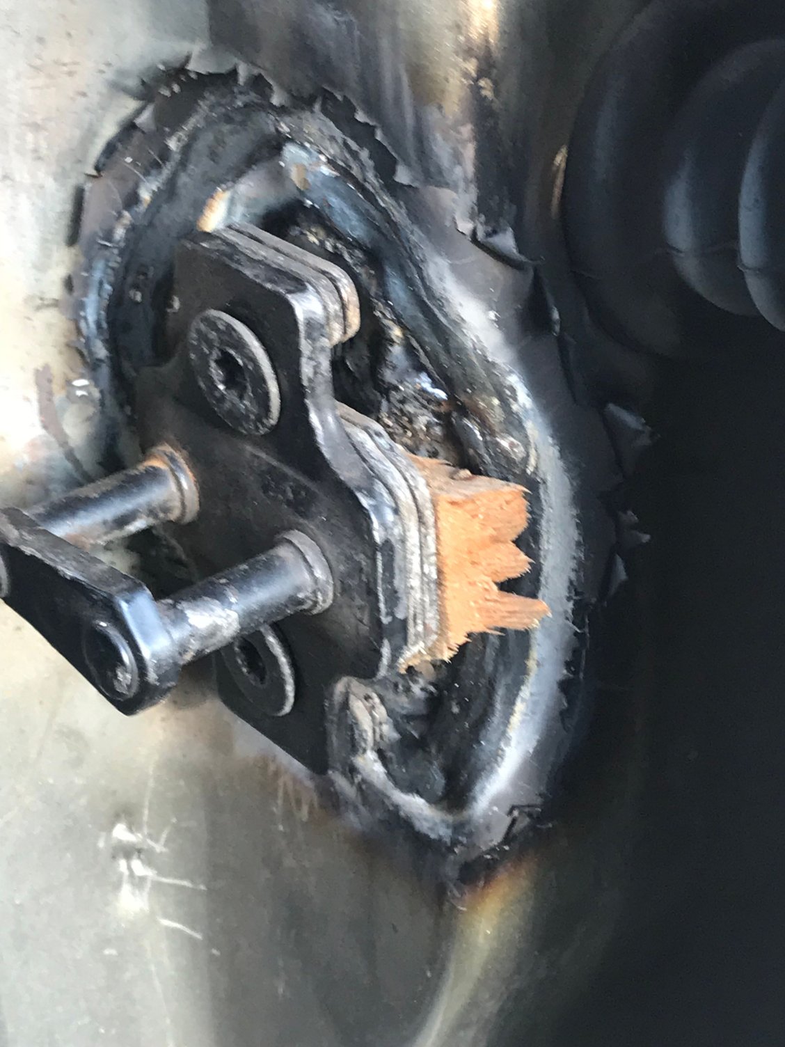

the driver side door is one problem after another- the hinge was shot (when we got it) so the door was not aligned properly- needed to be slammed for it to close properly- needless to say a few slams too many- and the inner door latch busted out (the frame broke)- we had it re-welded- and thats fine but the hinge is still rusted and shot- door wobbles up and down
Aside from replacing my entire door- best option?
New hinges?
used hinges?
welding or adding something?
I will add photos to the comments soon!

New pins and bushings won't help if the holes in the hinges themselves are oversized or out-of-round. What I did when I made the same repair on my wife's '00 Blazer was to put some quick-setting JB Weld around the holes in the hinges to get them back to their original size before installing the bushings. That way, the holes in the hinges will be restored to normal size so the bushings won't be unsupported. It looks from the condition of the bushings that maybe the holes in the hinges had worn oversized and the bushings began to break down. If that's the case, redo the bushings and pins and build up the difference between the bushings and the oversized holes with plenty of JB Weld and the hinges will be good as new.

From the pictures I would either weld (and that means fabricating parts) or get a replacement and weld or bolt that in place, or cut the hinge part and weld to existing support.
The OEM hinges are welded to the doors and to the frame and the pin and respective bushings act as the hinge.
Your's look shot (at least the upper one). The upper support of the pin is broken. Both bushings are shot. The door has an alignment issue which could be explained by the upper hinge being damaged.
The other issue is the lock side which broke ou of the frame. What has happened to that door?
The weld looks suspicious to me. Could be a torch weld which could explain why it broke at the edge of the weld.
All could be indicative of a hinge problem. The excess clearance makes the door sag. It will also damage the color on the lower part. (Fix it or it will rust your door away)
At the same time a quite high load of the doors weight in addition to rattling (clearance) while driving could have damaged the lock side.
This IMHO will need a pro fix as in properly fixed or more damage will follow.
