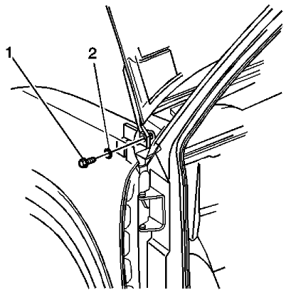

I have heard this described before and one of the answers are related to the hood hinge cone washer search around. I grabbed this when I saw it for when I needed it.
http://i11.photobucket.com/albums/a1...ge_tsb_img.gif

X2 Just reading the header I thought of the hinge washers.
Take a small rag & fold it a few times. Place it on the weather stripping under the hood on the side the rattle is. Close the hood & go for a drive.
If the rattle is gone - voila, you've found the source!

Anyways, the passenger side hinge bolt was only finger tight. The drivers side was very tight....but there is no washer on either side and local Chevy stealership shows no washer either.
I just removed the hood and am going to go for a drive down a washboard road and listen.
I was thinking of putting a nylon washer between the hood and the body.
I will edit this with what I hear.
I HEAR NOTHING......YOU GUYS ROCK!!!!
That was the source of the noise. There was not enough space to put the nylon washer in, so I just tightened up both sides and went for several drives...and no noise...it is GONE!
