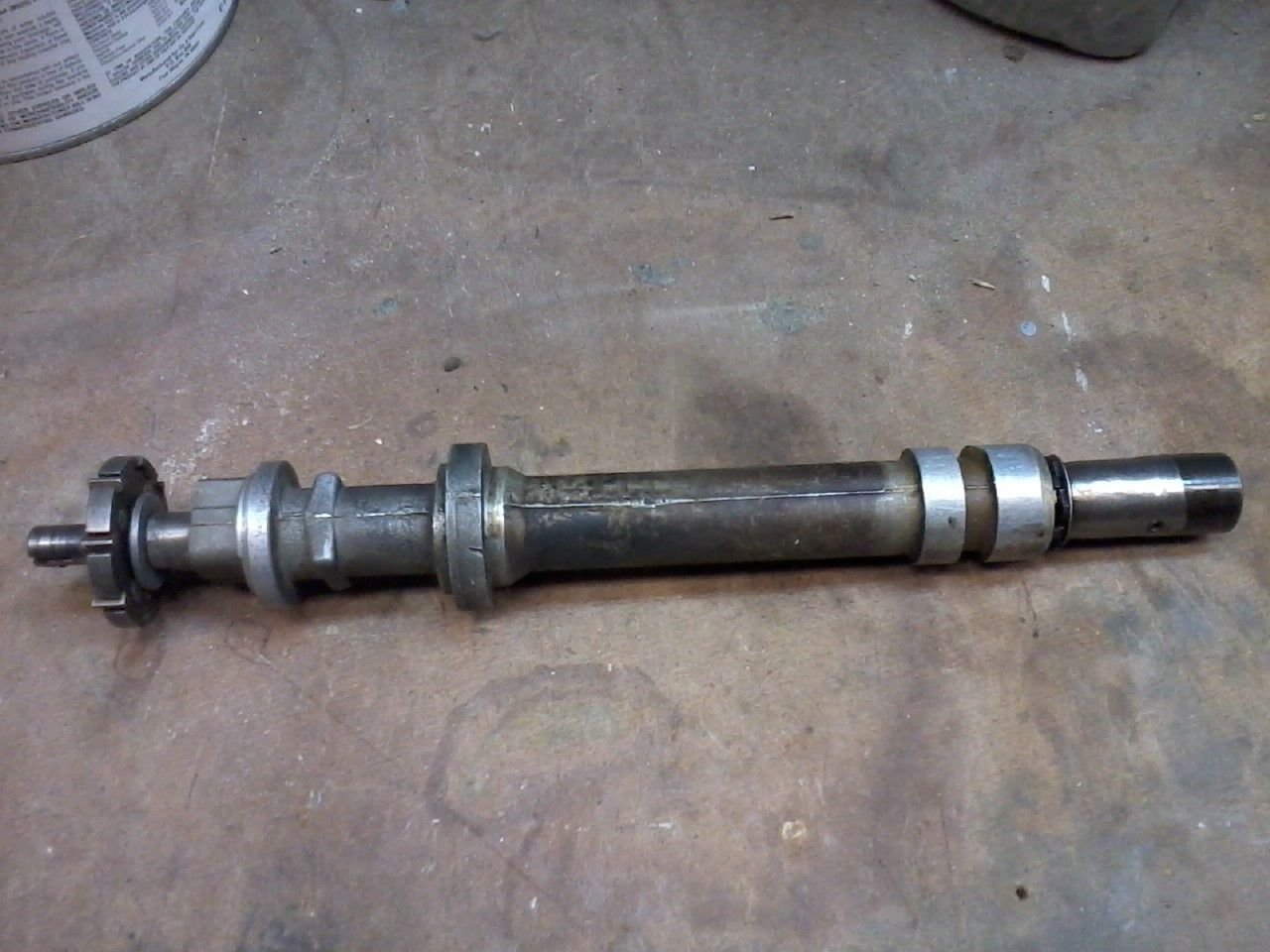

made from a old dist. harbor freight and most auto parts stores sell the ready made unit .
pull the dist. drop it in and spin the oil pump with a drill .....
