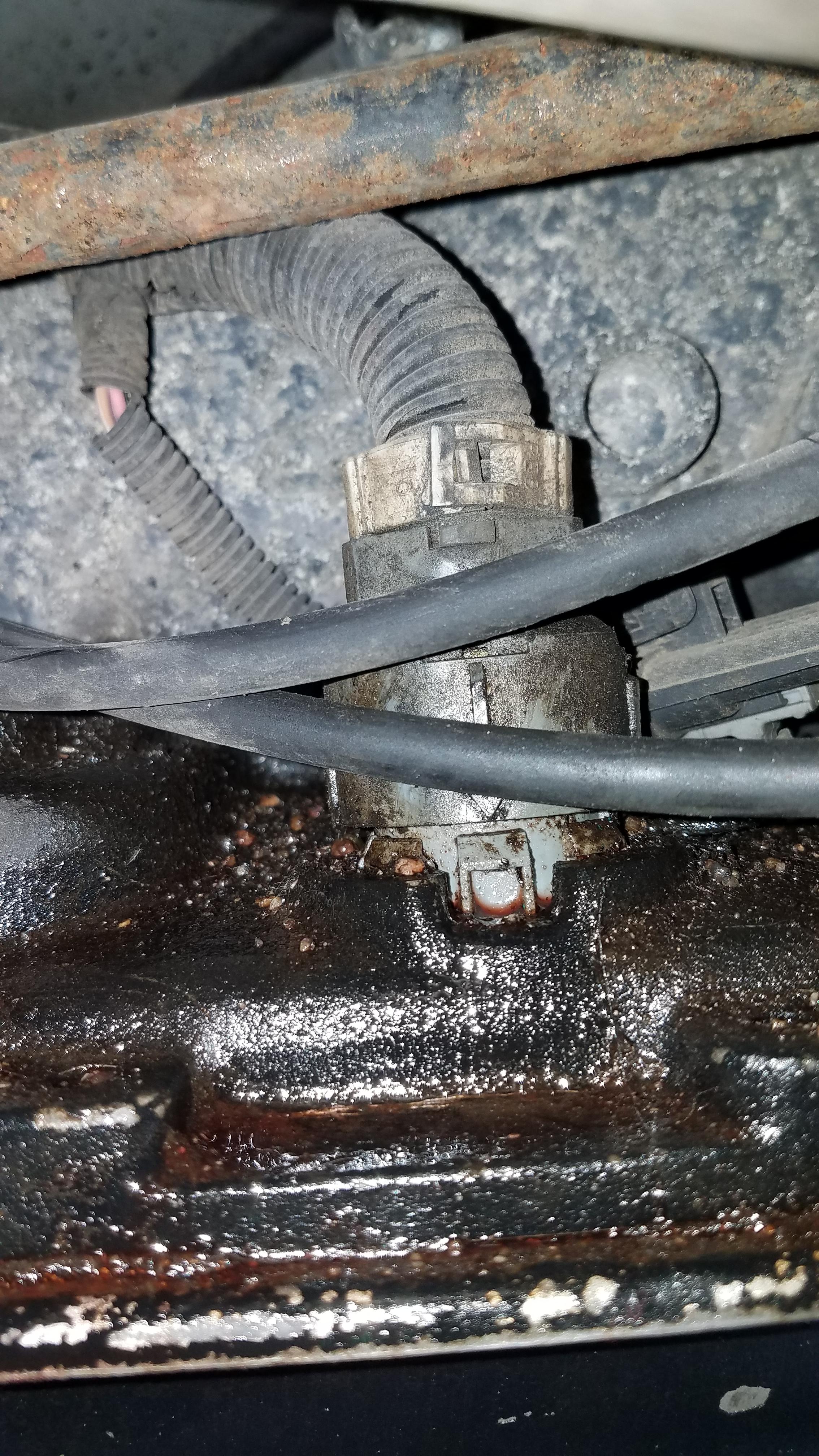

Anyone know what this is called? It seems to be the source of my transmission leak. See below. I'd like to know what it's called and what to replace, just the o-ring or the entire module? 1995 Blazer LT 4x4.

Where I believe mine is leaking, I have a puddle directly below this and losing a lot of fluid.

Its the main valve body harness that controls all the shift solenoids inside the trans. Not much you can do other than buy a replacement harness, drop the pan, and change it out.
Not a terribly difficult job, but you're better off actually REPLACING the harness if you go in to try and fix the leak, because from my experience those plugs get brittle and tampering with them causes them to fall apart... It IS just an O-ring that seals the plug to the trans there, but it would really suck to get the pan dropped and try to remove the plug to replace the O-ring only to have the plug fall apart in your hands and you be stuck with the truck torn apart...

Ok, think I found it. I take it these are known to leak? Anyone else have this problem?

I had that problem years ago when I had my blazer....ended up finding a new Oem on eBay cheap! Not a hard job just be careful and pay attention where everything goes..

That looks like it! Just make sure you you select the correct year, 2wd or 4wd, etc, while you're ordering it, as I know there where some minor electrical changes with the 4L60E trans through the years.
A couple years back I lost first and final drive gear on my 04, scanner showed that one of the shift solenoids were not actuating. I ended up replacing ALL of the solenoids while I had to dig in there, the harness, and of course did a fluid and filter change at the same time (which I would recommend at the same time btw). It's not a hard job at all, just take your time, be methodical, be clean (don't let any dirt or anything get in there), and keep track of where everything goes as you pull it apart.
I've never touched the internals of a transmission before this little project ever before in my life. I was a little nervous, but I was confident in my mechanical abilities, so I figured that I would give it a shot. In the end, it was a breeze, only took about 30-45 minutes (granted I had a lift to put the truck on, that made it easier...), haven't had a single issue since the fix, and I'm sure I saved myself THOUSANDS, as a shop would have surely said "you need a new transmission"...
