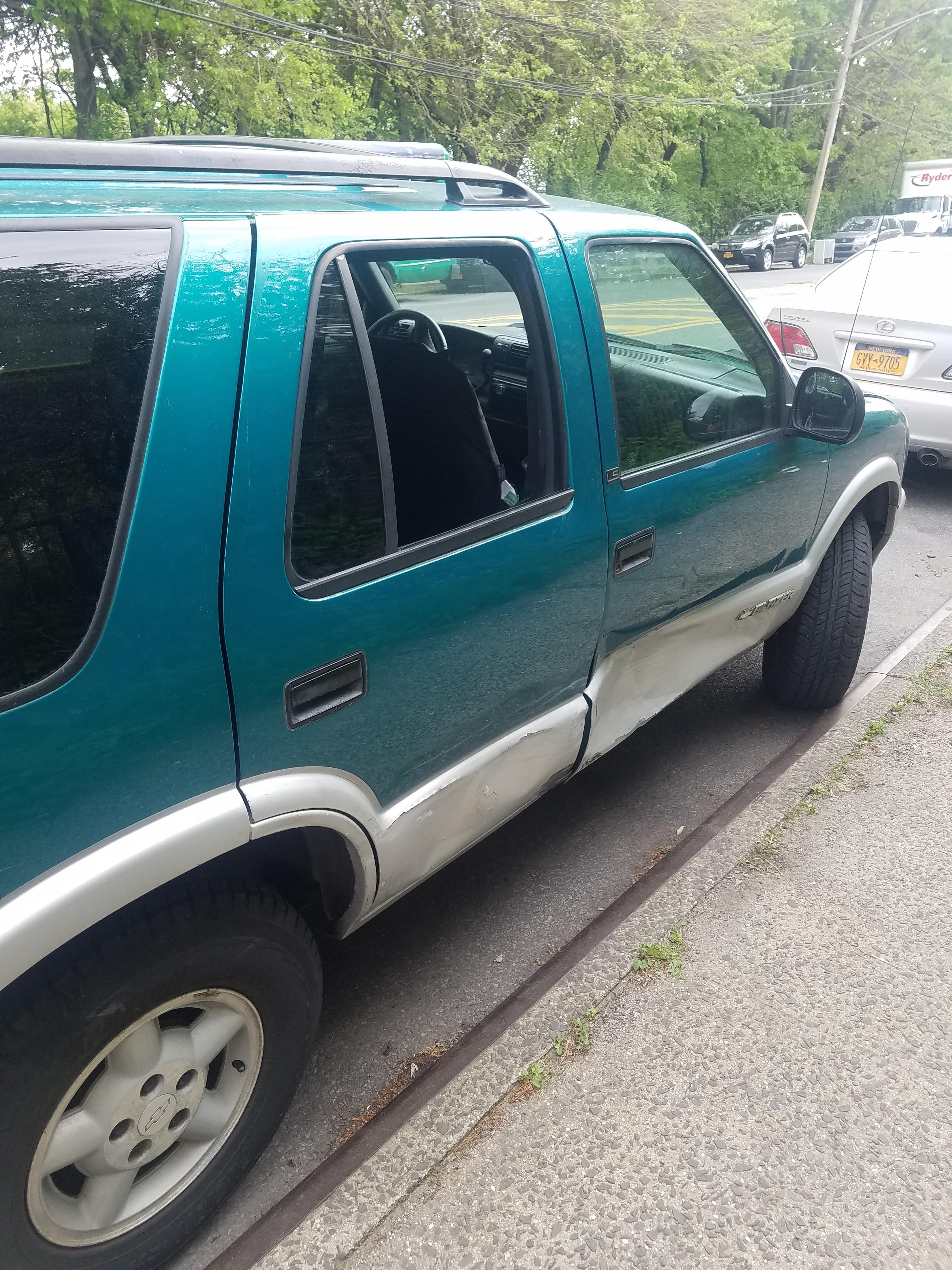

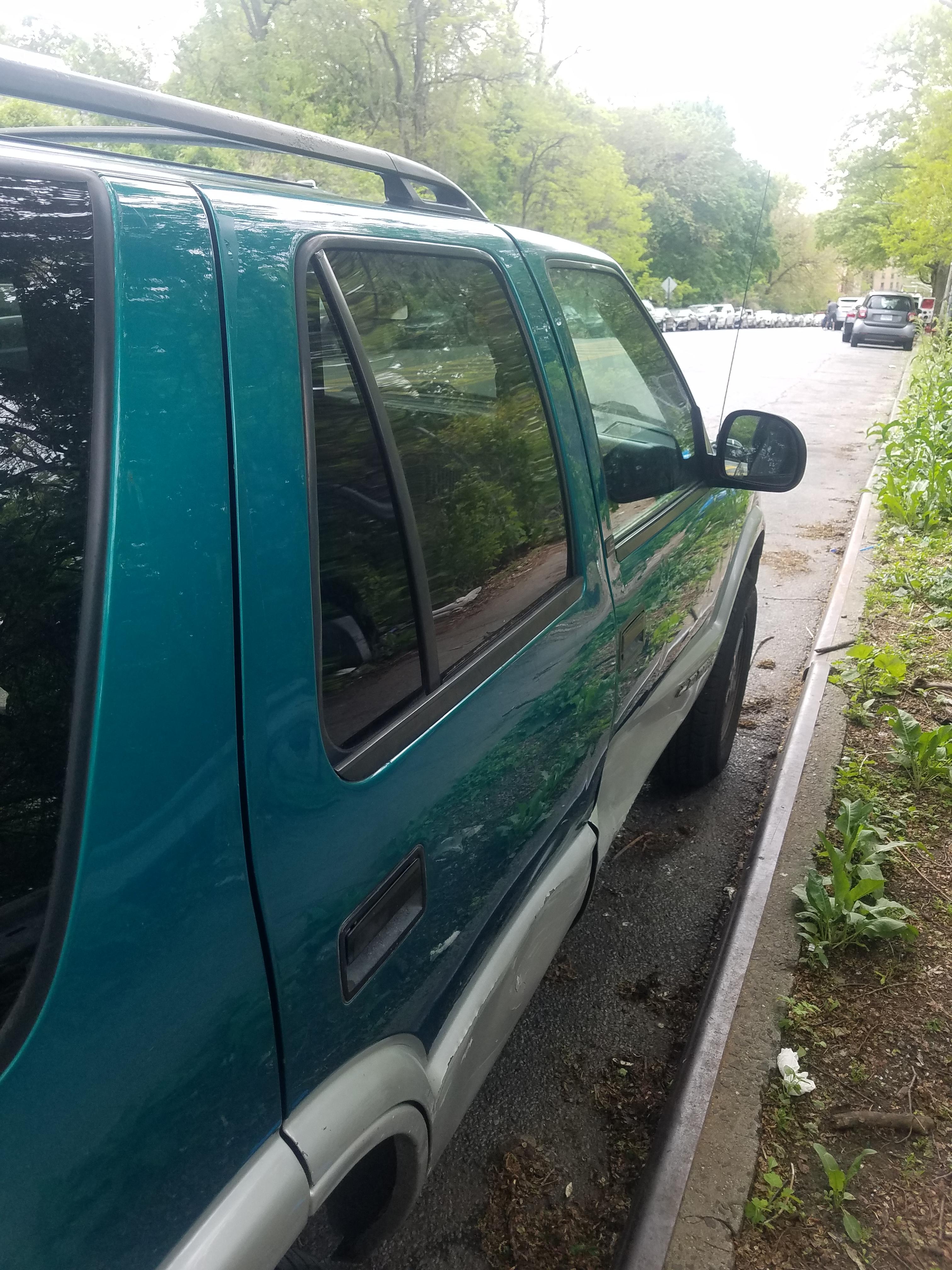

Pretty sure the motor is shot as I can say there is power going to the door. Weak/dead door motor..
Two pics, for expediency:

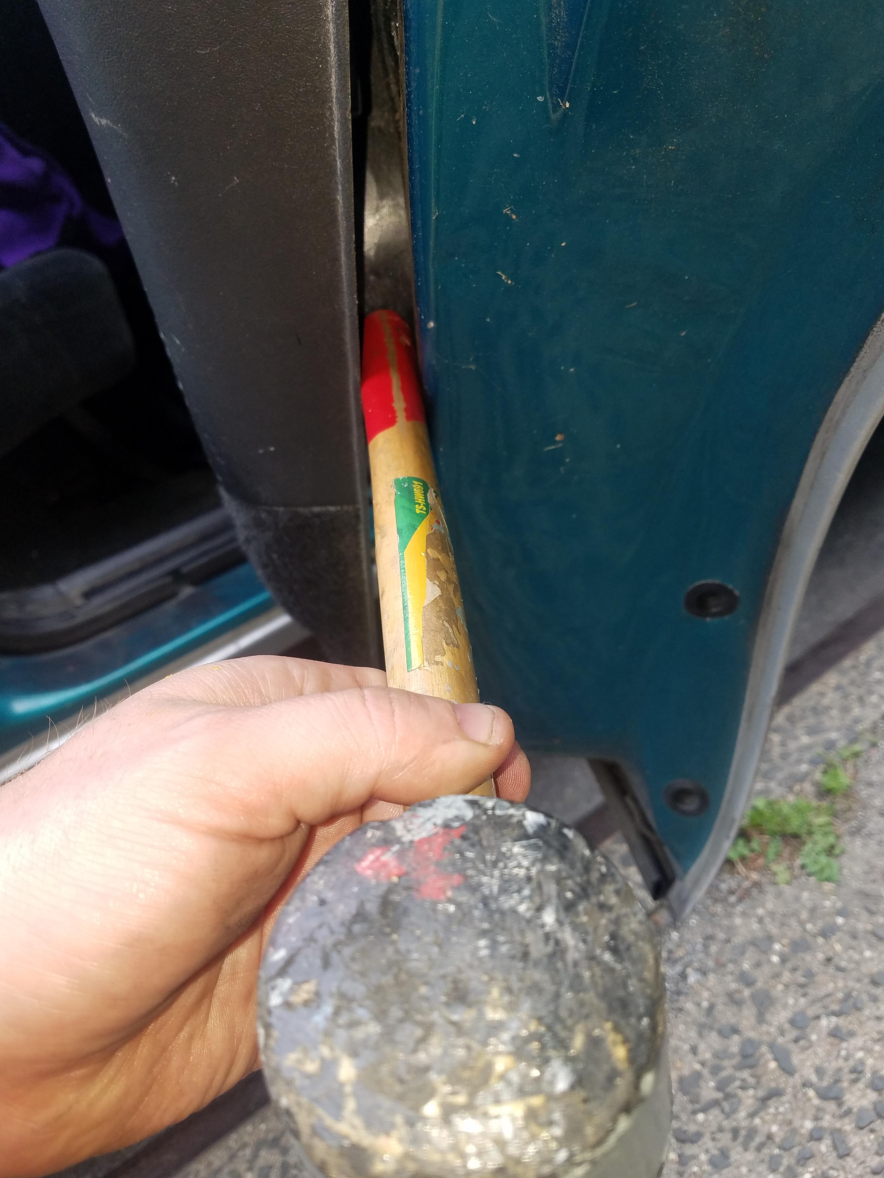

Question. If I get a screwdriver on the protrusion the wood end of the mallet is on (I assume that is where the door window motor is?) pretty aggressively either while ththe car is running or the ignition is on.. will this help it go up?
I do realize sprays like WD-40 is useless because that is a motor issue and spraying along window track will not get to the motor..
Sale fell through when buyer put window down and it wouldn't go back up.

Hey.. looks like that thing I was banging on was the speaker.
And, also.. Window Lock was on the whole time.
Took that off, and was able to get the window up.
Now... should I spray silicone down the sides of the windows?

LOL, I hear you. When mine (2002 2d) got stuck a month or two ago, acting on a tip I got here I whacked the motor with a hammer a few times and it has been working fine.
