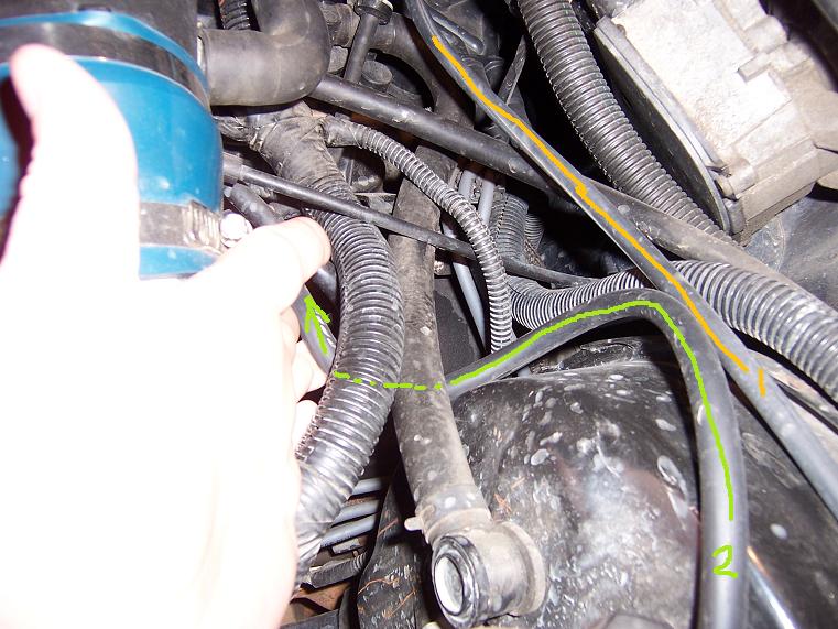

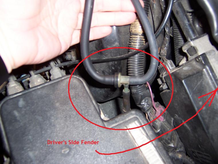

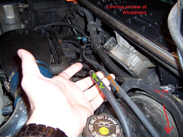

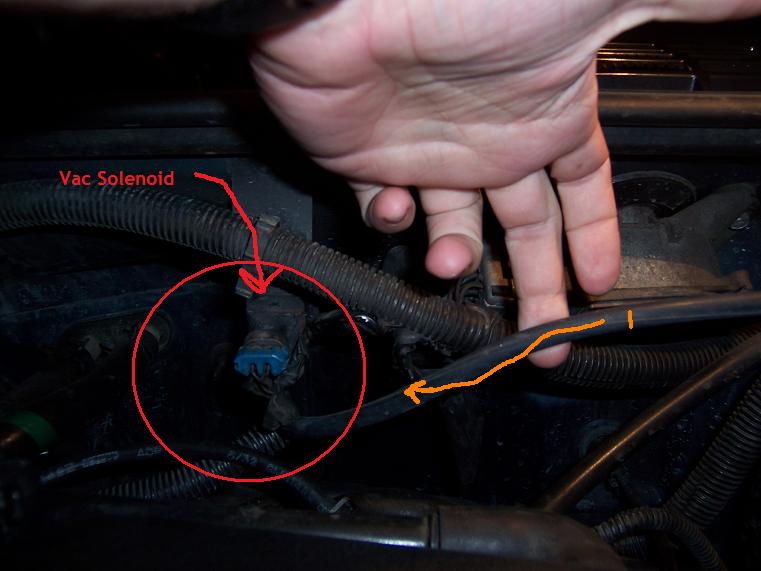

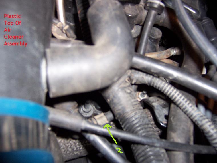

i'm on it. ill trace mine out for you real quick. give me 5 minutes or so.
the vac res ball looking thing is on the older blazers. yours is a 99. mine is a 2000 so it should be a similar set up. (i have the 4 button though...)
anyway hang tight. BRB
**EDIT**
pics below with explainations in their titles FTW!
Attached Thumbnails quick 4wd ?..hopefully-1-t.jpg   quick 4wd ?..hopefully-2-following-hoses.jpg   quick 4wd ?..hopefully-3-hose-one-solenoid.jpg   quick 4wd ?..hopefully-4-hose-two.jpg   quick 4wd ?..hopefully-5-hose-two-t-behind-air-cleaner-housing-throttle-body.jpg

thanks for those great pictures! I found out that the little black panel on the fender actually has a fitting on it, with the canister on the back side (literrally inside the fender). I hooked it up...... Still wont go into 4x4. I bought a chilton guide hoping for a vac diagram, no such luck. Im going to replace the switch on the front rear end on the right side where the axel shaft is. Im so aggrevated, I was going to sell it today! Everything is in perfect shape except for that. Any other suggestions?

I checked the valve underneath the battery tray, unhooked it..Checked the hose connected to. The hose is sucking air and that valve beneath the battery tray seems to be working..
