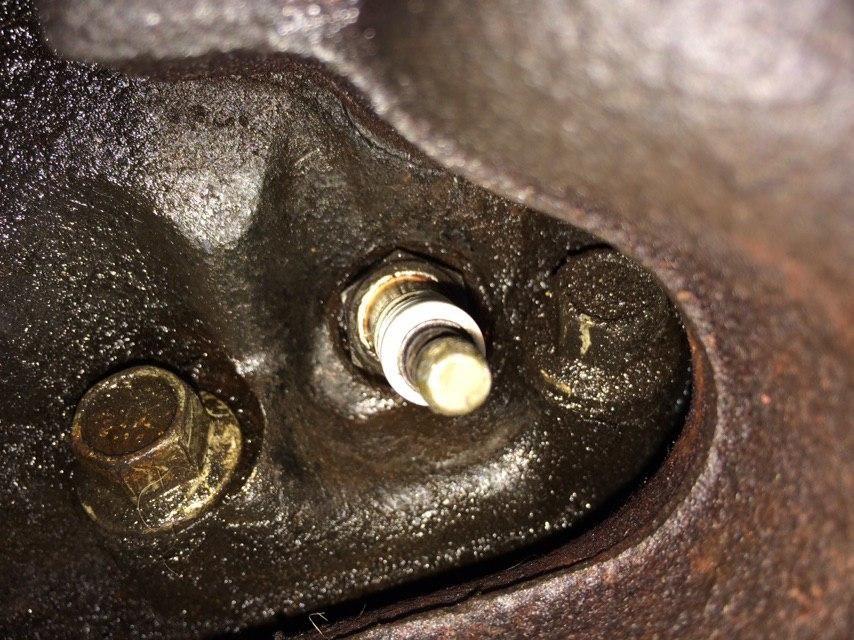

So overdue update, but I finally had a chance to remove the heat shielding and get a look (And pictures)
The issue appears to be that there is an "Arch" so to speak over the top of the plug, and the clearance between the arch and the plug hex is not enough to let a socket in. Or anything, for that matter, which will allow it to spin free.
I CAN spin it slightly, either by carefully jamming a flat head in and trying my luck, or using the very ends of a open end wrench. However, will it spins somewhat easily enough like that, I can only get it about 1/8th of a turn before I cant get a grip on it, and it does not spin freely enough by getting a finger in there.
Here's some photos:
Not sure where to go from here. The plug causes a misfire on extended idle and a light "tick" where I can see the end of the wire bounce up and down a bit with each tick, but otherwise it's not causing any other issues I can see? All I can think to do would be to remove the entire Exhaust Manifold on that side, which I'm not keen to do at the moment as I have no idea the shape the bolts that connect to the Y pipe are in.
I'm also worried about how I could prevent this in the future, if I ever do get it out.
Any suggestions welcome.

Have you tried a "non-spark plug" deep socket that may be thinner?
George
Old Apr 7, 2020 | 07:47 PM
BorderCougah's Avatar
Joined: Dec 2018
Posts: 81
From: St Louis
BorderCougah is on a distinguished road
From the looks of it, I'd need one with pretty damn thin walls. Barely a couple millimeters, and probably the same socket shape outside as inside. I did try a non-spark plug socket I had, but even banging it in with a hammer couldn't clear the arch.
