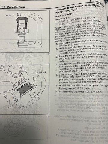

looked in the service manual, some had nylon injection in stead of clips, showing
some fancy tool used to disassemble...instead of heating them up and melting

For me it is interesting to learn that there is a special tool to remove factory U-joints. I don't have the tool, so I heated the joint with a propane torch until the goop ran out of the hole.
On one occasion I used a Spicer U-joint, and another time I used an AC Delco Professional u-joint. Both u-joints have grease nipples.

and i really dont understand how that tool worked....does it matter...no
