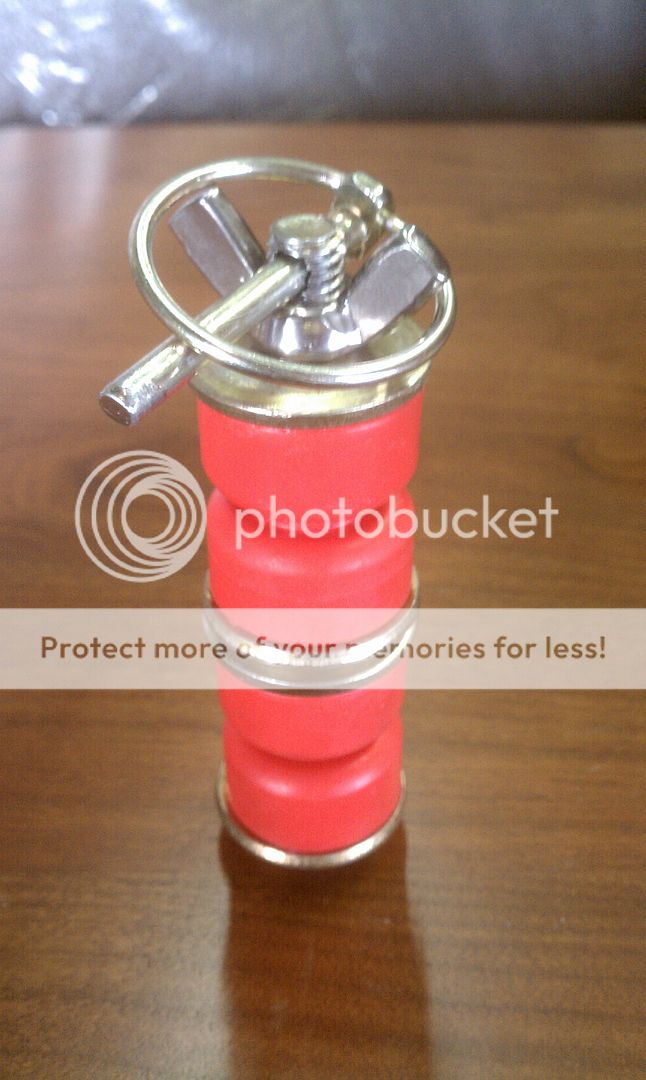

These aren't my pictures, because I don't want to go crawl in the snow to take any of mine. They're from this thread. For some reason his bolt is too long, but it should give you a visual of what the bushings should look like. Once they just barely start to bulge on the sides stop tightening.
***EDIT***
I knew Rexmburns had pictures somewhere but I gave up too soon. Here's a link to his build thread where he did a quick disconnect on his sway bar, and you can see the urethane bushings tightened down. Hope he doesn't mind my borrowing his pictures!
Well I managed to get some quick disconnects made for the front sway bar. I still have to make something to hold it out of the way when disconnected but my factory bushings and bolts were shot so I figured I would go ahead and make these instead just replacing them with regular bolts and washers.
Heres some pics if you have questions ask
Compared to the old that I had to cut off!
And installed
