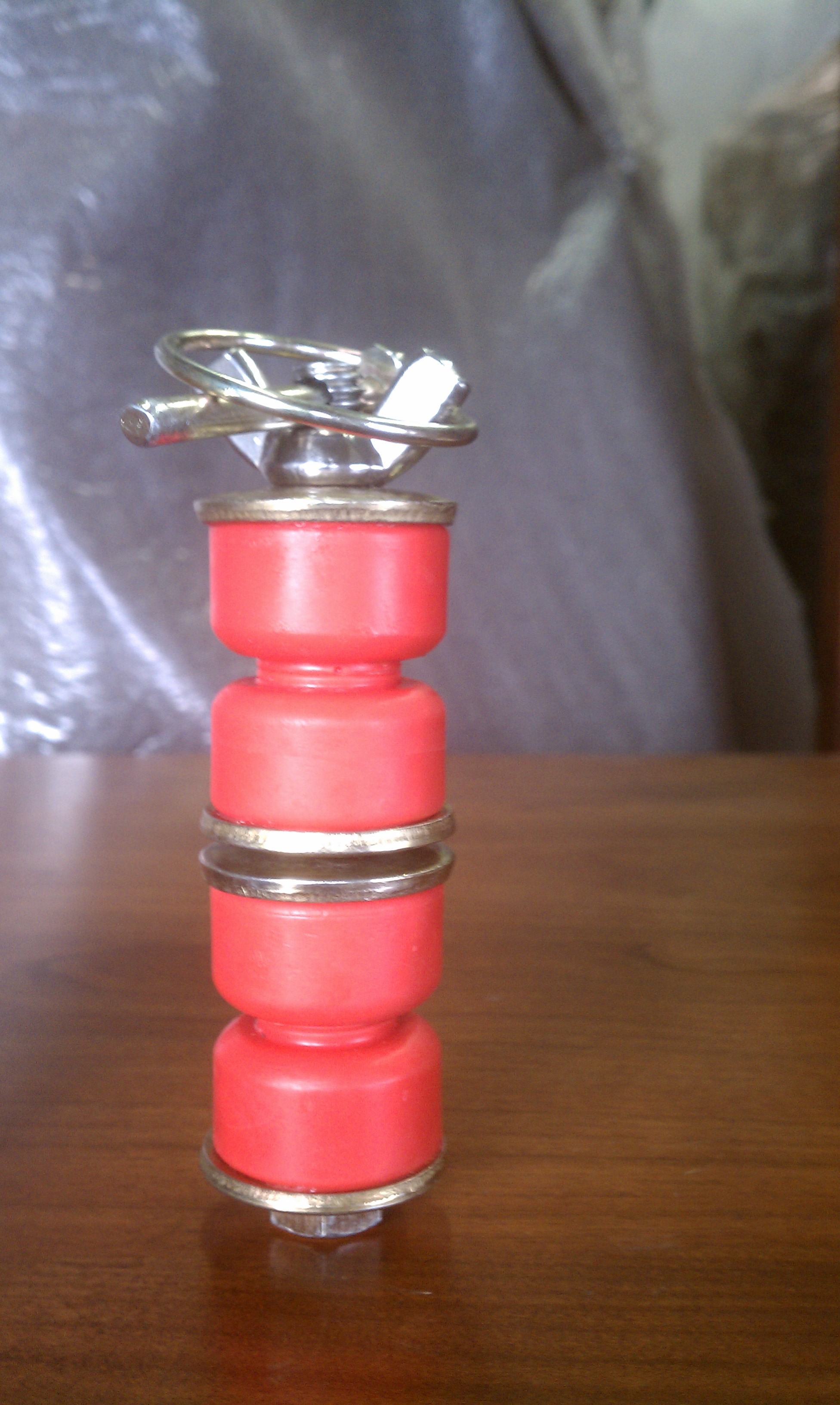

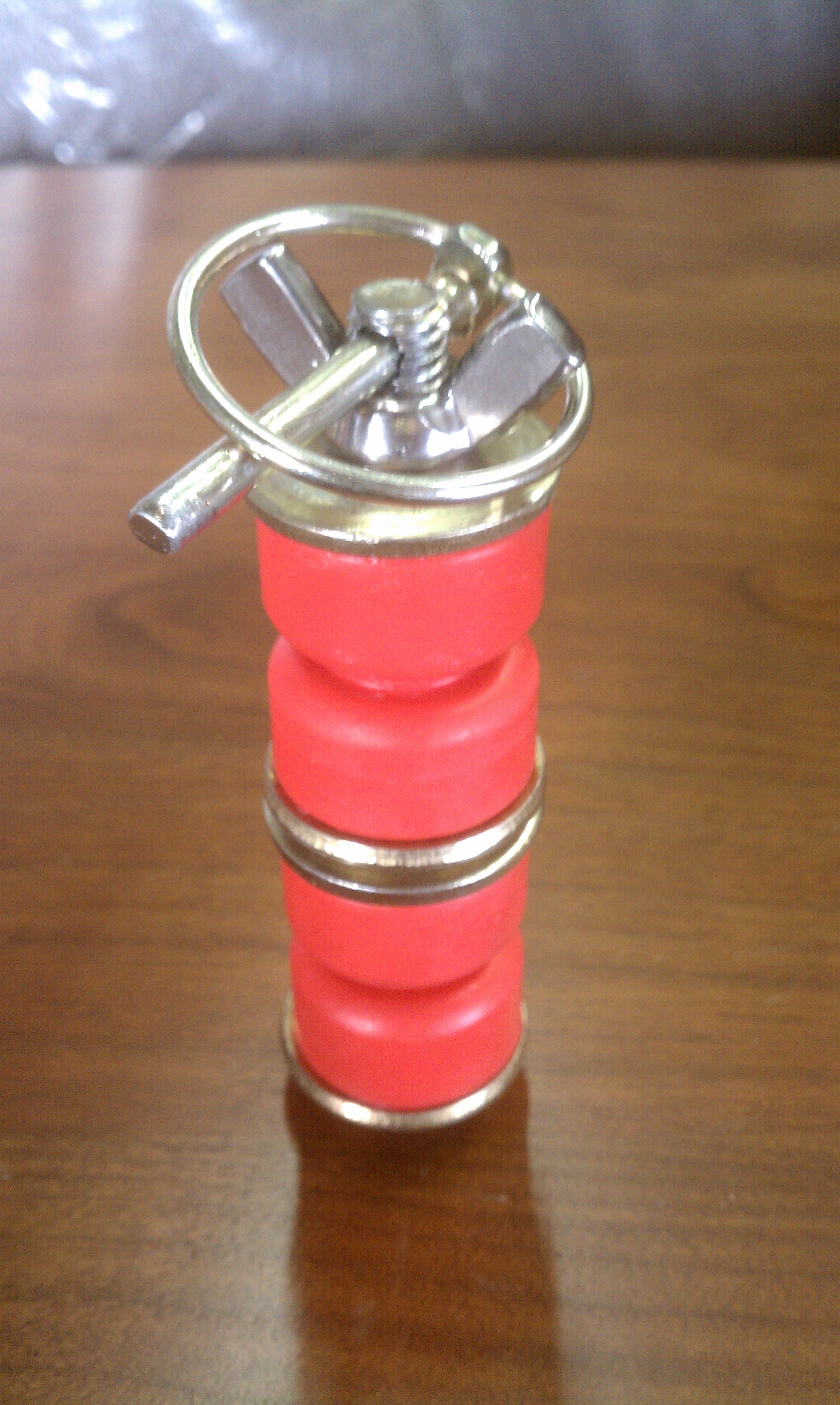

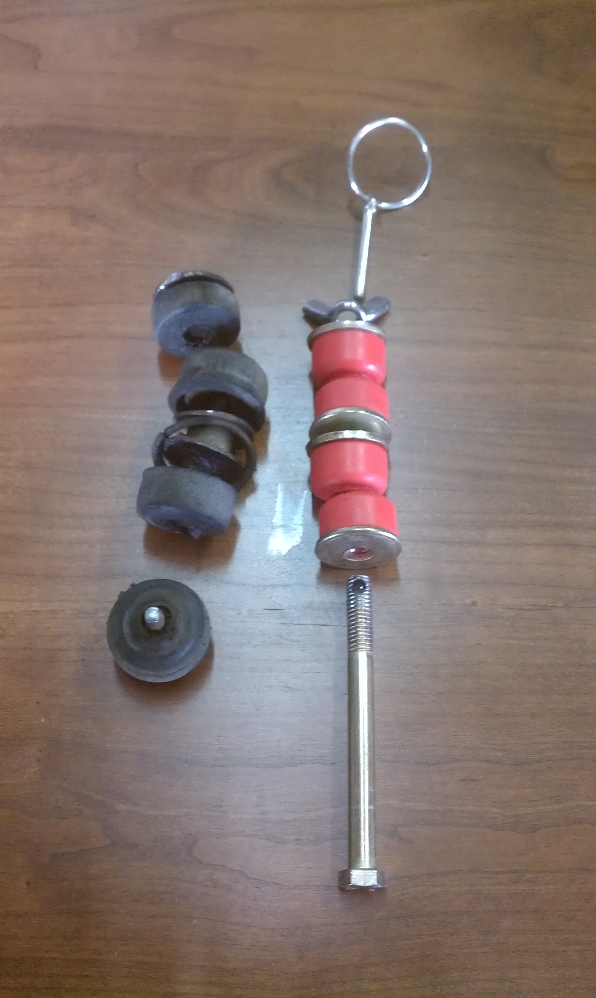

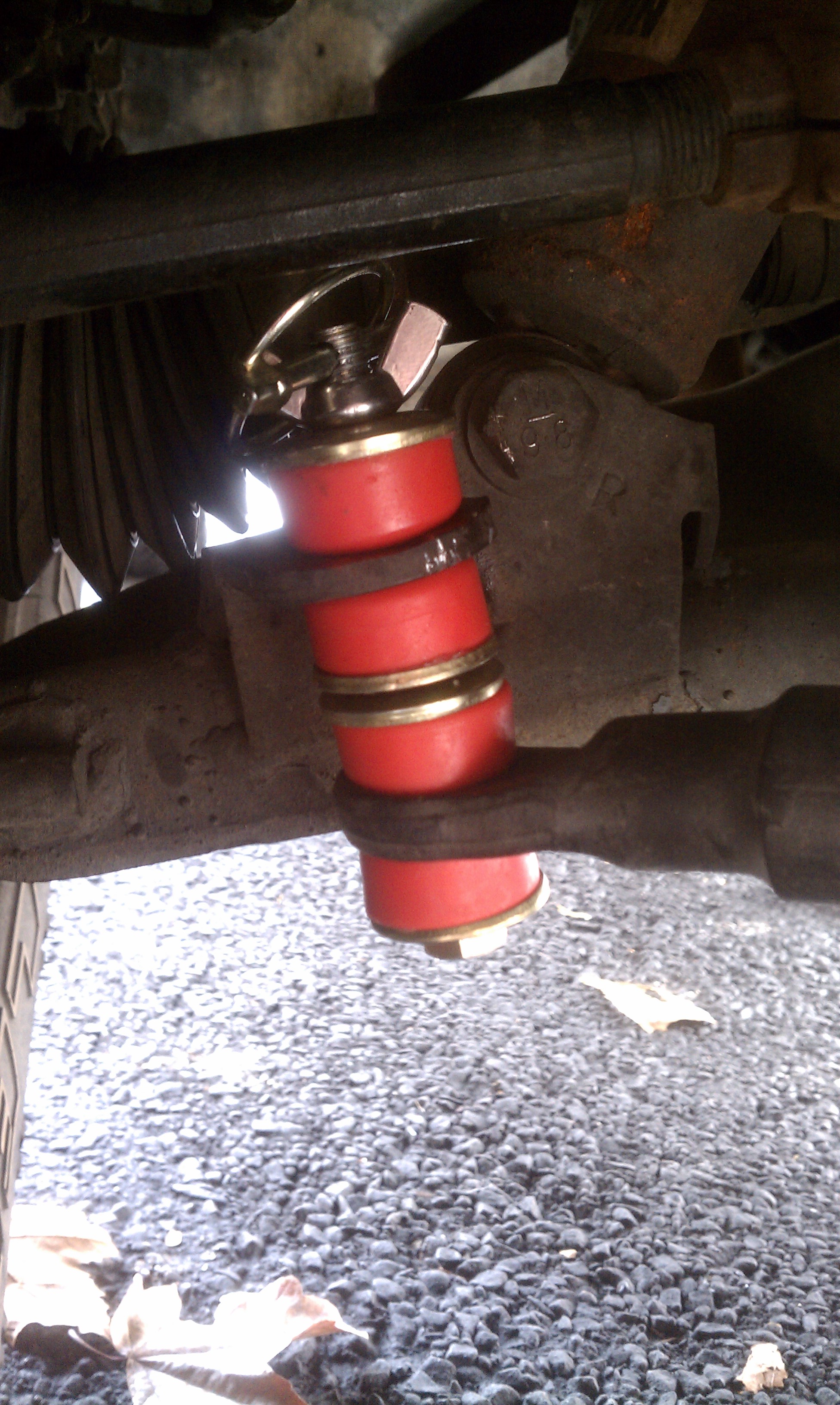

Well I managed to get some quick disconnects made for the front sway bar. I still have to make something to hold it out of the way when disconnected but my factory bushings and bolts were shot so I figured I would go ahead and make these instead just replacing them with regular bolts and washers.
Heres some pics if you have questions ask
Compared to the old that I had to cut off!

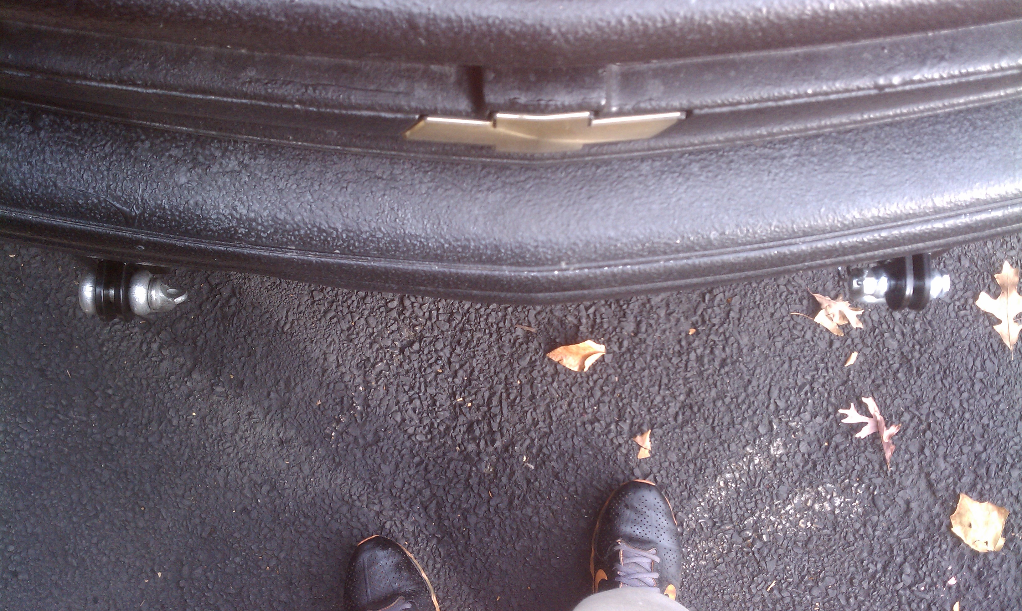

And installed

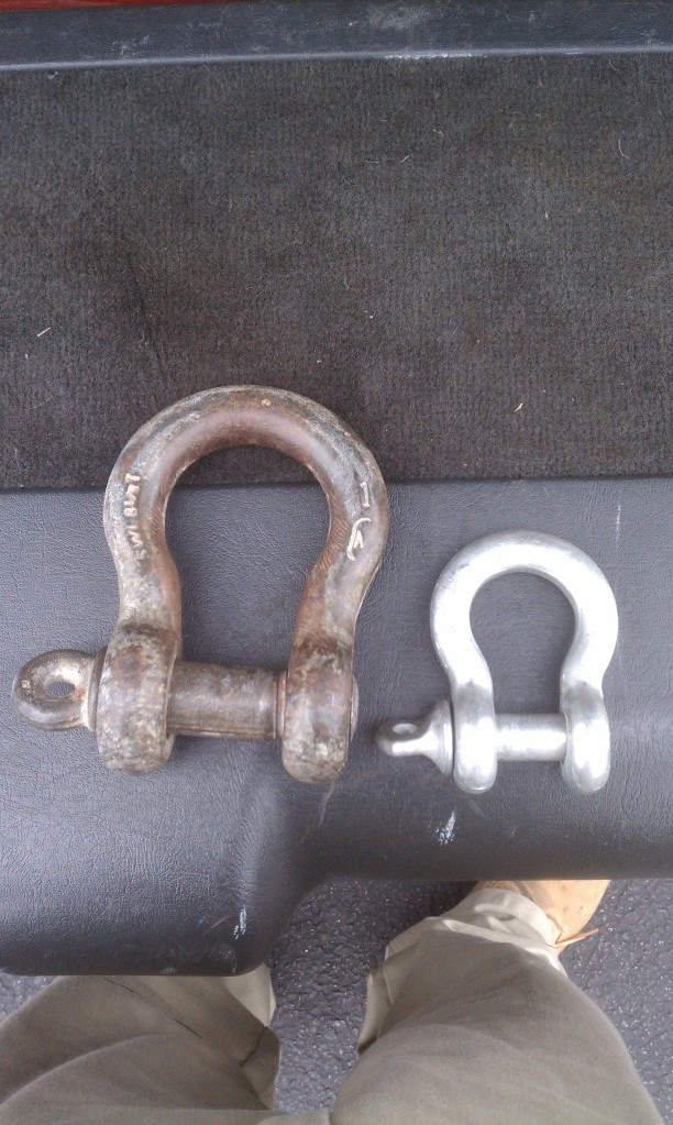

I hated how the little shackles that came on the Harbor Freight receivers looked so I ordered some beefier 5/8 shackles on ebay to swap them with. I had to drill the receiver tube a tiny bit to fit the larger shackle but it was worth the extra effort IMO.
Heres a comparison shot of the orignal (right) and 5/8 shackle (left).

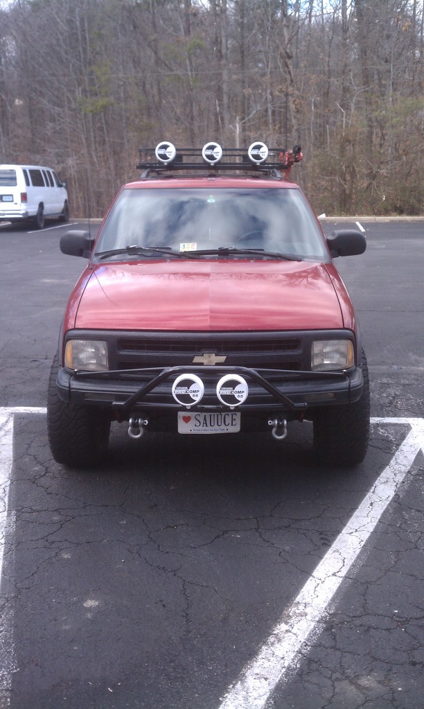

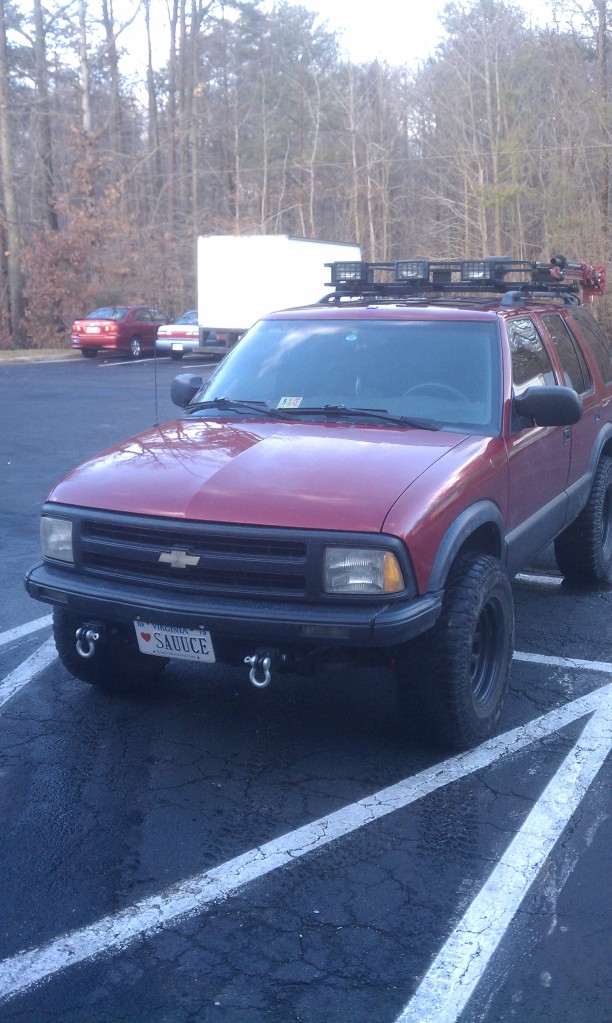

Well I got a few goodies for xmas and have a few of them on so far No point in talking about it much everyone wants to see pics anyway!
Before
After

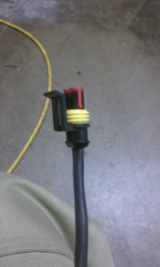

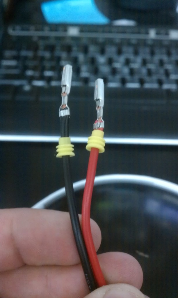

I don't have any of the wiring done yet. I am going to replace my battery with a yellow top and do a ad244 upgrade before I put power to the lights and I want to take my time and do a nice clean install on the wiring. My current battery and alt have a hard time keeping up with the factory setup let alone any accesories I will be gathering the needed supplies for that. I did manage to put some connectors on the two lights on the front heres some pics.
Nicely crimped
All together with some shrink tubing around the wires to keep them pretty and protected.
I did both lights like this and will do the other three this way as well so that they have weather proof connections and will be easilly removeable if needed.

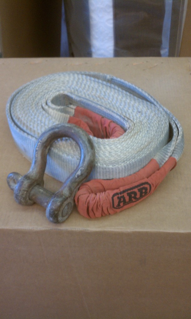

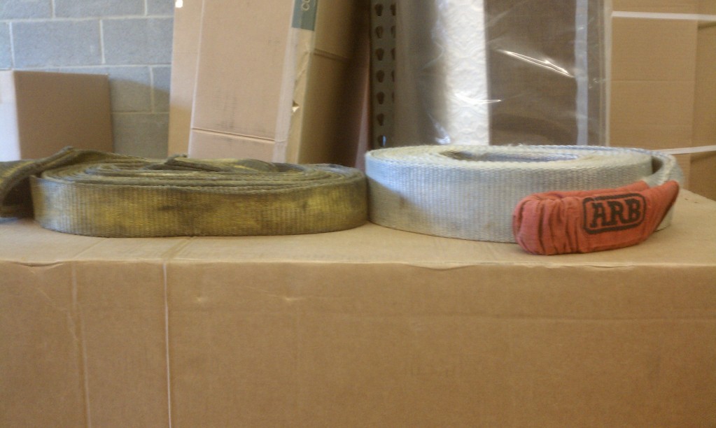

My new to me ARB tow strap and shackle came in as well. I picked them up from a guy on s10forum for $35 shipped I think I got the better end of that deal than him lol!!

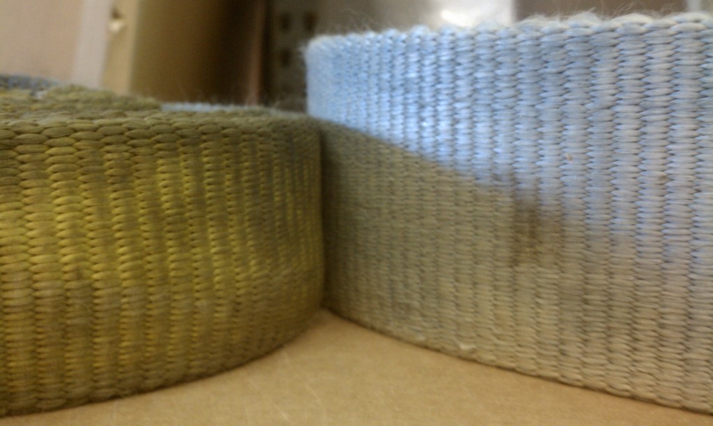

Compared to my old strap
Its pretty thick!
And just to show how large the shackle is! The smaller one is the shackles that are in my front receivers! I'll be putting this in the hitch out back.
