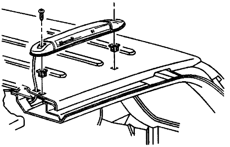

I don't know if yours is the same as mine, but if it is mounted to the roof of the truck, I think all you have to do is remove the screws holding it down. You will have some holes in the roof you may need to seal up to keep water from getting into the vehicle. To get to the electrical connection, you may need to remove the rear upper trim panel inside...
Here's a diagram:

Thanks. It looks easy but after removing the screws I wasn't able to move light. So maybe easier is to remove trim inside. Is it simple?

If you cannot remove the light with the screws out, it is mostlikely due to the gasket holding the light on. I would try to gently pry the light up with something flexible and non-marring between the gasket and the body of the truck (so you don't scratch it). The only thing that retains the light to the body is the screws. From there, it's just the light, the gasket, and the body... Nothing mechanical holding it.

Remove the screws and grab it and twist/tilt it until it comes off. Use some muscle! If that doesn't work, try the non-marring prying technique suggested above.
The only things holding the light to the truck are 2 screws and a gasket.

yea...take out the back trim panel and the connection will be hanging right there above the light
