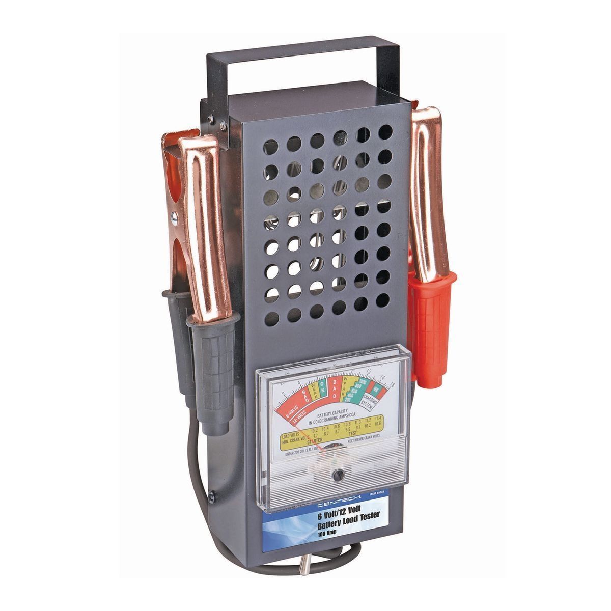

A properly charged battery reads 12.66V with no load on it. You charge it fully then knock the surface charge off with a moderate load like the headlights for 20 or 30 seconds, then you measure the voltage on the top of the battery posts with the truck completely off. So this is the first test of a healthy battery, that it will hold a 12.66V charge.
Then you have to see how much the voltage drops under a specified load which is done with a load tester that temporarily draws a very high current, like 100 amps and see how far the voltage drops. A parts store can do this for you. Here is a consumer load tester::
In the absence of a proper load tester you measure the voltage at the battery terminals while cranking to see how far it drops.

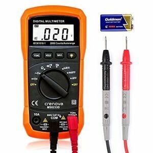

To answer your questions...I have been taking the readings at the battery posts....well side posts and I have been using a multi-meter set at DC voltage. Unfortunately I don't have a more sophisticated tester. As to starting, it starts normally...door chime...interior light comes on....engine catches at first try....the instrument panel warning lights flash on for a second and then ALL go out...NO security warning light....the headlights don't dim.
The one curious thing I noticed is that the instrument cluster back lights now slightly FLICKER. They don't go out just a barely perceptible change in voltage....after running for a few minutes they seem to stabilize and have a steady glow. Maybe alternator is starting to fail.
this is the meter I have used

A few things:
It is not likely that your battery voltage is actually fluctuating from 9 - 16 volts. If it did, the 9 volt level would likely cause the PCM or other functions to drop out. The dash gauge is more dampened but I would still expect to see some needle movement. Make sure that you are making firm contact on the battery center bolt after you have cleaned the contact point with sand paper. Check both battery/cable connections for corrosion or poor contact. If that's really the system voltage when the truck is running, retest with the truck off but the ignition in the run position. That much fluctuation, if real would likely be caused by shorted/dying cell(s) in the battery. Can this battery ever get charged to 12.6V and hold that after 20 seconds of headlights then off? What is the battery voltage at the terminals when cranking?
A failing alternator would not cause this much voltage fluctuation with a good battery, the battery acts as a large capacitor and dampens voltage changes. A running voltage of 12V, if real is too low. I would start with seeing if the battery can be charged and hold 12.6V and see how it does in a load test. Check all wiring at the battery, alternator and starter. You can have the alternator tested if you want but I would get to a confirmed good battery with tight clean wiring first.
Which dash lights or gauges drop out?
George
