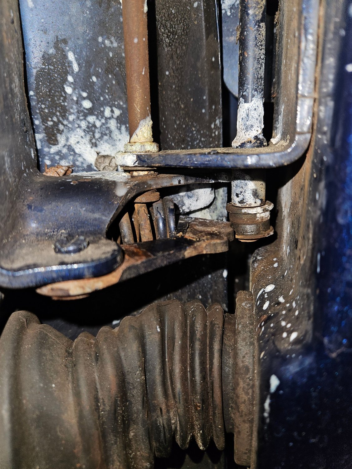

The weatherstrip appears to be working and keeping out water. I have discovered a new problem though. On both of my doors the grommets that hold the pins in are broken. I plan to replace the pins on both of my doors. has anyone replaced those pins? I have a 2002 Chevy Blazer ZR2. I would like to know the model or part number for my replacement pins as well as how to remove and reattach the spring in my doors. I have attached a pic of the spring. Thank you all again for any and all of your help.
Old Sep 2, 2025 | 09:42 AM
El_Beautor's Avatar
Posts: 2,750
From: Southern, Alberta
Replacing the door pins is a rite of passage for Blazer owners. The easiest method I've found is to support the door (from above if possible). A couple ratchet straps hanging from above work really well for this as you can adjust the height and angle. If the pin holes are ovaled out from wear, you may need oversized bushings or even to repair the holes, depending on how worn out they are.
For removing and re-installing the spring, I highly recommend buying the
door spring removal tool door spring removal tool
. Any place like NAPA, Harbor Freight, or Amazon will carry it, and it will make your life so much easier than trying to pry the spring out with a bar or a screwdriver.
