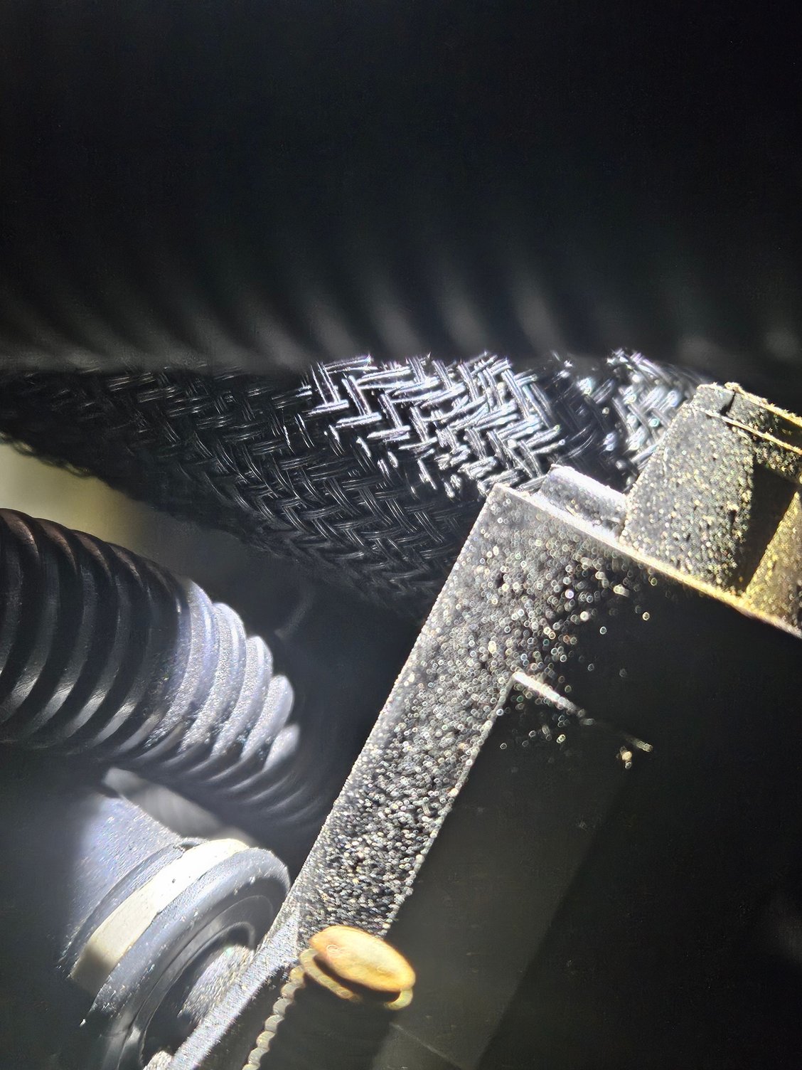

I want to use a smoke machine to test my evap system on my 2002 Chevy S-10 Blazer ZR2. I am attaching a few pics of what I think is the purge valve on the engine. If I am correct and that is the correct line to use how do I remove and then reattach that line? My vehicle has a white fastener on that line. It looks fragile. I don't want to break it.
Thanks for your help and expertise.
