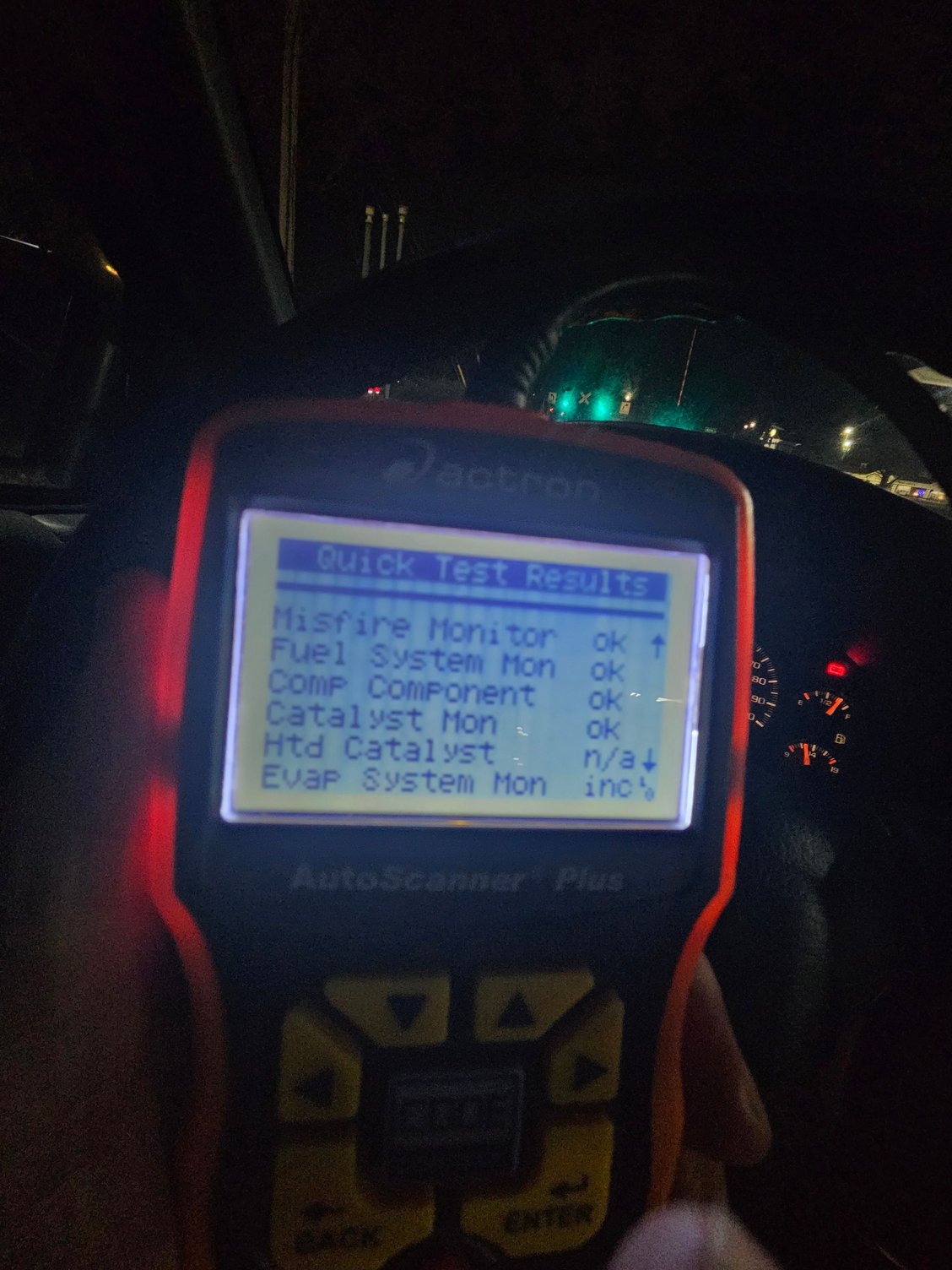

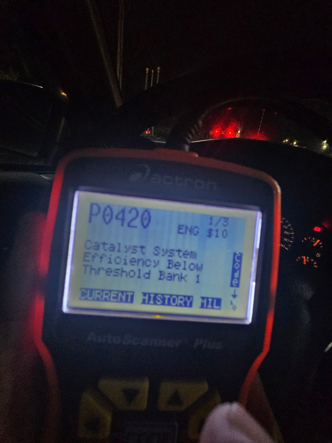

The ck engine light just came on in my Blazer. The interesting thing is this time the catalyst monitor
completed 1st...the Evap monitor is still incomplete. Here is the code. There is only one so far. What r ur thoughts? What is the cause for this code?

P0420 means that the post-cat O2 sensor is reading the same frequency of cycling as the pre-cat O2 sensor. Typically that means the cat converter is not retaining any oxygen (is not functioning) and needs replacement.
Imagine the green trace (below) cycling with the red trace. This plot of normal operation captured using Torque Pro for Android during a time period of about 5 seconds at 2000 rpm in park. Contrary to popular belief, pre-cat O2 sensors always actually cycle when they are controlling fuel mix. Exceptions are too lean, too rich, hard acceleration, or open loop when first started. For the pre-cat O2 sensors, as long as cycling crosses 0.45 volt, the fuel mix is being controlled.
