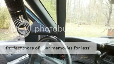

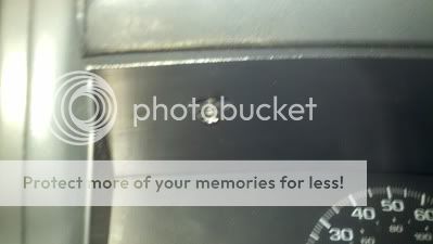

To begin, tilt your steering wheel all they way down. This will give you more room to work with when removing the bezel. Then take the two screws out of the upper part of the gauge cluster holding the plastic to the dash.
I put all of the bolts and screws in my cup holders so they wouldn't get lost.
Pull the bezel off only enough to undo the clips holding it to the dash.

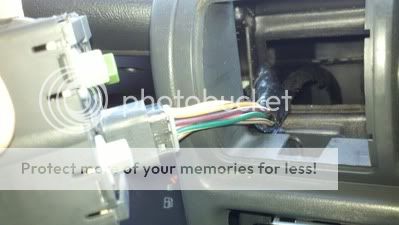

Unclip the 4WD harness from the back of the switches.

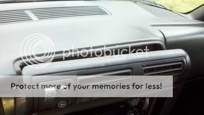

To give yourself more room you can either uncoil the harnesses from the headlight/wiper/hatch switches or completely remove the switch master from the bezel. I didn't do either. I pull the bezel out far enough to where I could just flip it up and over the steering wheel and lean it against the drivers side a-pillar. You may have to put your shifter done into 1st to get enough clearance to get the bezel off.

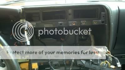

You now have access to everything you will need to remove as far as a head unit installation goes.

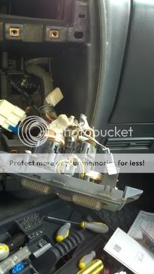

Remove the bolts holding HVAC controls, head unit and lower pocket to the dashboard. They are all the same so you do not have to worry about putting them back in the same holes.
Pull the HVAC controls out and let them hang out of the way.
Pull the head unit out carefully remembering the antenna and wiring harness are still attached to it. Once you have it out far enough. Unclip the wiring harness and antenna from the back of the headunit and place it someplace it won't get damaged.
Remove the pocket and put it out of the way for later.
Your dash should look like this at this point:

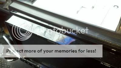

Remove your double din head unit and single din dash kit from it's packaging.

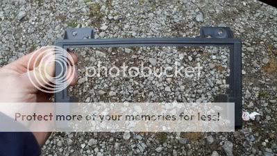

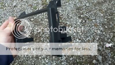

Using the BACK of the head unit, hold it centered against the front of the dash kit and mark how much you need to trim off the bottom.
Using whichever tool you feel is best to cut a clean straight line (I used a hack saw), cut the dash kit to the markings you made previously. Sand down all of you cuts so there are no sharp edges that can cut yourself or any wires.

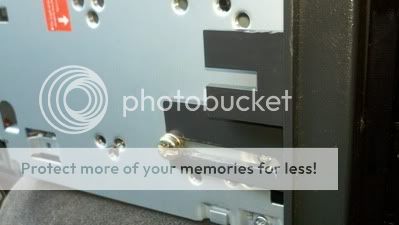

Test fit the dash kit to the head unit and make any necessary adjustments if needed.
Find a way to secure it the the head unit. Mine fit almost perfectly to the screw holes in the side of my unit but you may not be so lucky. Some creativity may be needed depending on what dash kit you get.

Once your switches are connected, Carefully go around the dash bezel and push the mounting clips into their locations. Once that is done don't forget the two screws in the top of the gauge cluster.

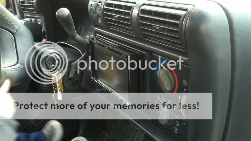

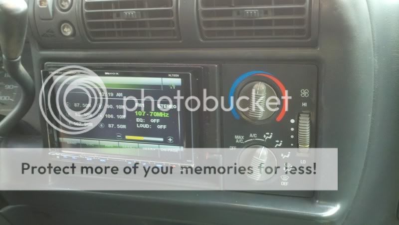

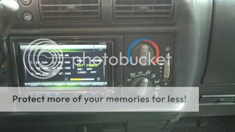

Sit back and enjoy your new head unit...
**Don't be alarmed with how far mine sticks out from the dash. It a cheap $150 head unit. You get what you pay for. A decent touchscreen double din will run you about $800-$1000. When you spend that much on a unit. It will more than likely sit flush with the dash kit. I didn't want anything crazy, just an upgrade from stock with the ability to use a scan disk and DVD.***
