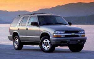

Thanks for the reply. I've noticed the gigantic ZR2 logo on many Blazers, and I certainly don't have it. I suppose I just have a 2002 Chevrolet Blazer LS 4WD 4-Door?
I just want to make sure I got the name right for the sake of people asking.
http://media.ed.edmunds-media.com/pi...19-300x189.jpg is the same as mine.
Old May 31, 2011 | 05:56 AM
TheRandom1's Avatar
Joined: May 2011
Posts: 1,924
From: Tinley Park, IL
Yup, that's just a regular LS model.
