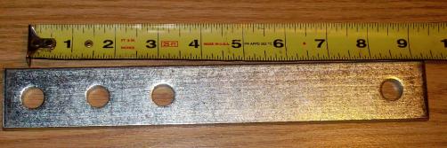

Hey guys today i bought shackles . now 2 inch lift shackles are 8 inches between holes if im correct. The ones i bought are 8 1/2 inches . that means imma get 2 1/2 inch lift?
would it look good with an 1.5 inch tbar crank?

no no what happen was i know 2 inch shackles have the holes 8 inches apart from each other.
i bought these shackles today and the holes are 8 1/2 inches apart now then means im going to get 2 inches 1/2 lift if im correct .
im also doing a 1.5 tbar crank in the front . would it look even ? or a little high in the back
heres a pic of the shackles

I'm not sure what I read BUT - stock measurements (center of bolt hole to center of bolt hole, or bottom of bolt hole to bottom of bolt hole & + 2" = 1" of lift. Thats because you're lifting only half the rear leaf. (one side/end of it)
So lets say you have a shackle that's 2" longer than stock, that equals 1" of lift if only applied to 1 shackle. That's it - 1 inch of lift in the rear.
If your stock shackles are 8" & you got 8-1/2" shackles (measured from the same places) you have 1/4" lift in the rear!
my stocks are 4 inches and the new ones are 8 1/2

Then you'd have 4 1/4" lift - if the bolt center to center are the same

someone told me that every 1 inch added to the shackle is 1/2 lift . i think it sounds about right
You take the new length minus the stock length, then divide by 2.
( 8.5 - 4 ) / 2 = 4.5 / 2 = 2.25

yea just wanted to make sure i was doing it right thanks swartlkk
