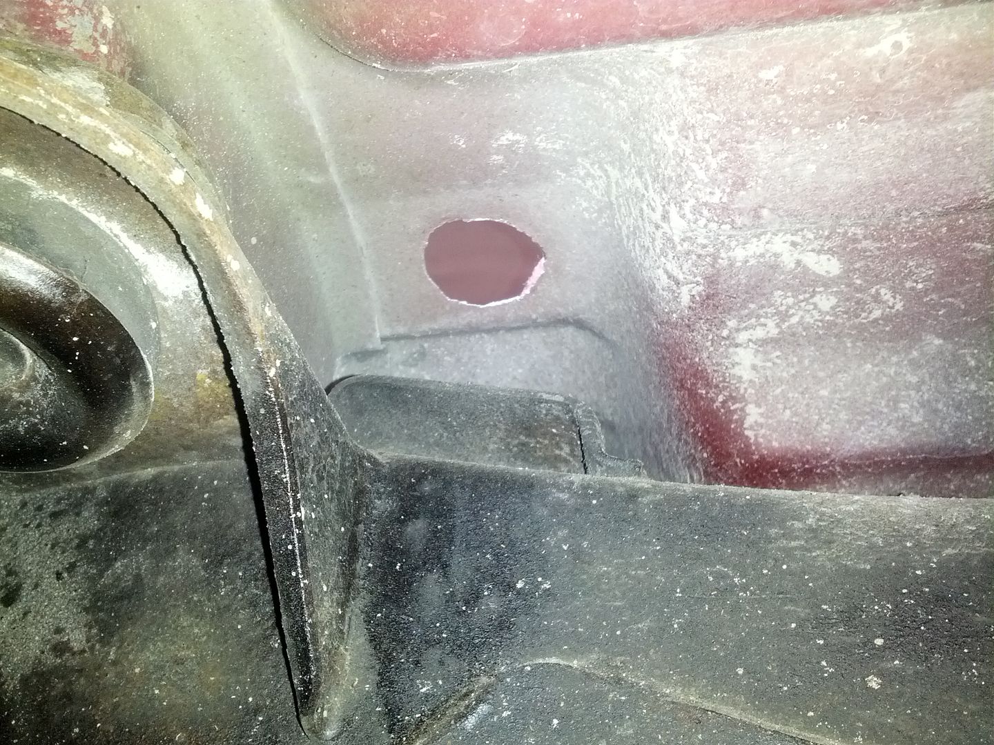

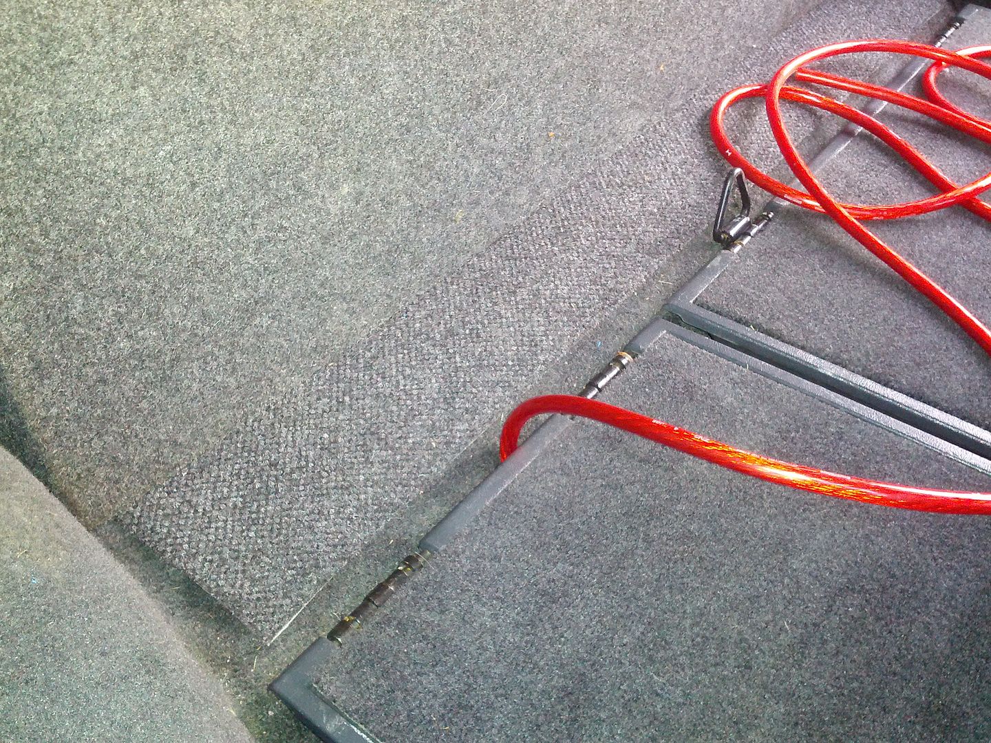

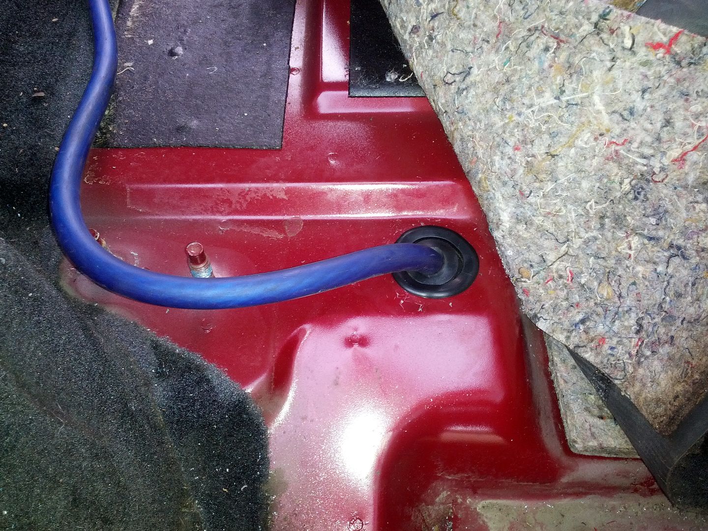

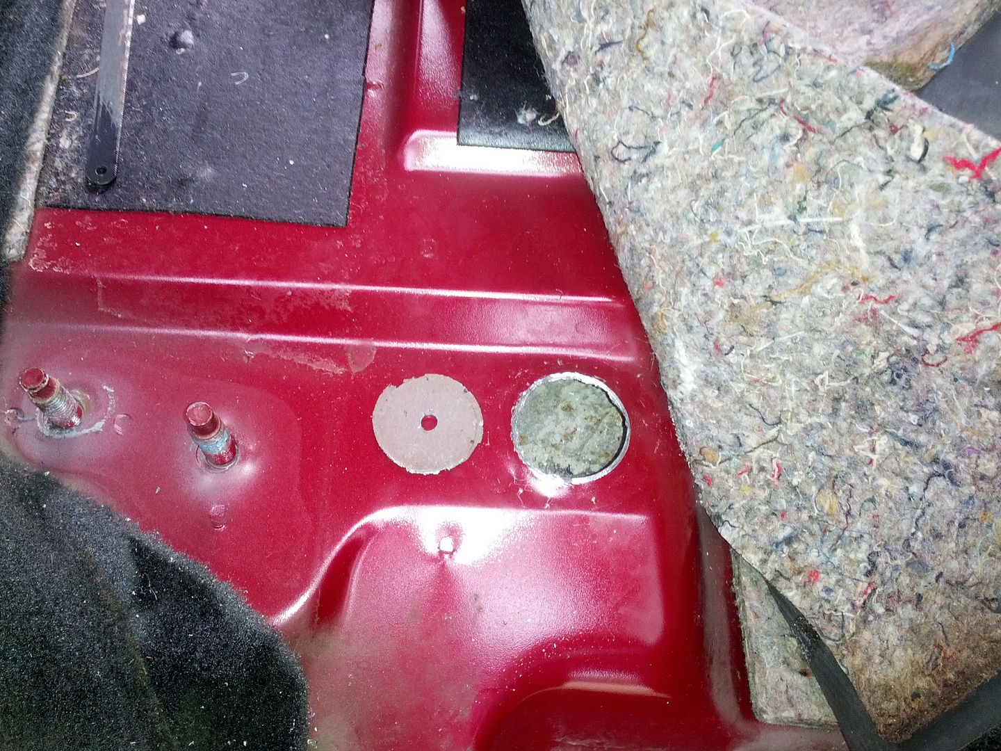

Depending on the gauge of wire you're trying to run, you can squeeze up to about a 4 gauge through the antenna grommet on the passenger side after you open the hole up a little. Just don't forget to seal it up with a little silicone afterwards, they're prone to leaking with just the antenna wire in it...
For my 0 gauge, I ended up running along the passenger side frame rail and came up through the floor under the rear seat via a drilled hole and a grommet I popped in place.

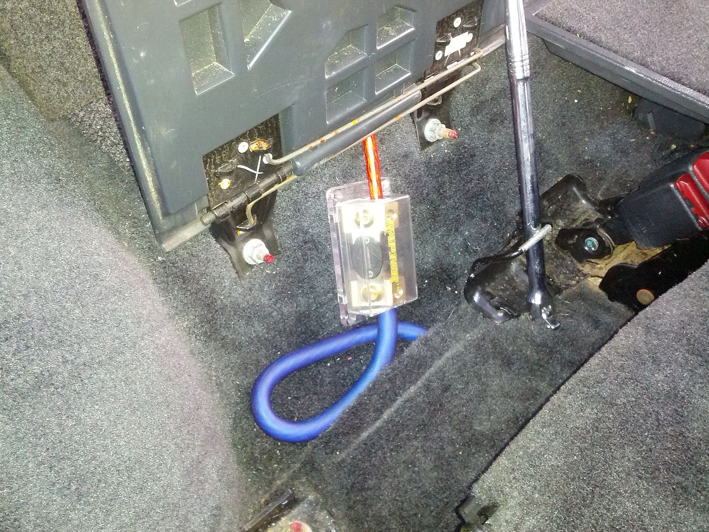

Ended up adding another fuse junction where it terminated under the back seat, which has worked out great because I've been able step it down to 4 gauge with some of the various amps I've had in the truck.
