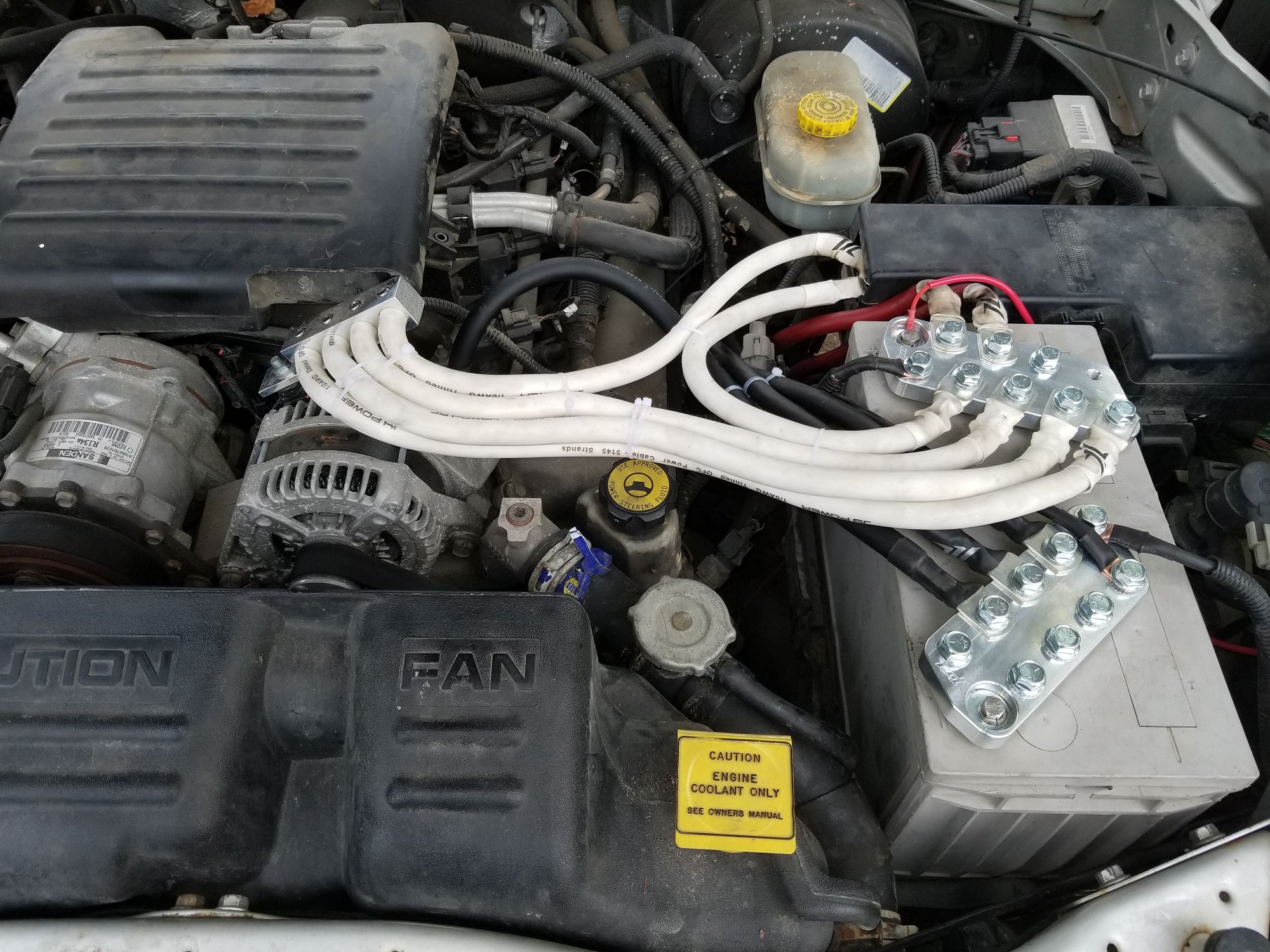

1/0 will sit under the side trim piece by the door with next to no noticeability. also if your running a system large enough to be running 1/0 make sure the rest of the electrical is upgraded as well. if not you are going to put a major strain on your alt and battery killing both fairly quickly not too mention the headlight dim at night when the bass hits. here is a dodge Dakota I did running 8000 watts. quad 1/0 runs front to back (2+ 2-), 320A alt and 5 batteries (750ish AH total).

those bus bars and heavy gauge wires so close together and criss-crossing make me feel uneasy...
theres plenty of space between the pos and neg on them so theres no chance of touching. only way they would ever touch is if the person decided to unbolt the terminals from the battery. if you think that's a lil hairy though you should see loads of others that have up to 6 alts on their blazers with 2-3 runs of 1/0 off each alt to the batteries lol. ill be doing a dual or triple alt setup in my blazer once I start on it. currently just gathering the gear up slowly.
There is more than enough space. Check out some of the loudest audio systems out there.
this is true. Went to world finals competition years n years ago and some dude was there with some foreign car that's stupid tiny called a panda and he had something I've never seen before with 20+ runs of 0g that was mere centimeters apart craziest **** I've ever seen....dude ad 2 cactus sounds 18s on 4 oldschool soundstream xxx 15ks.......he blew one sub testing and still did a mid 160s on the meter sealed on the dash.....quite impressive really.
