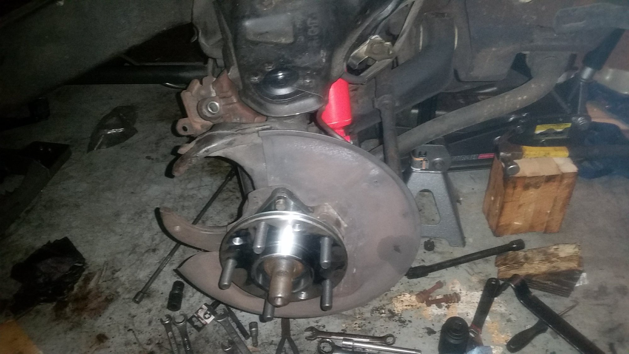

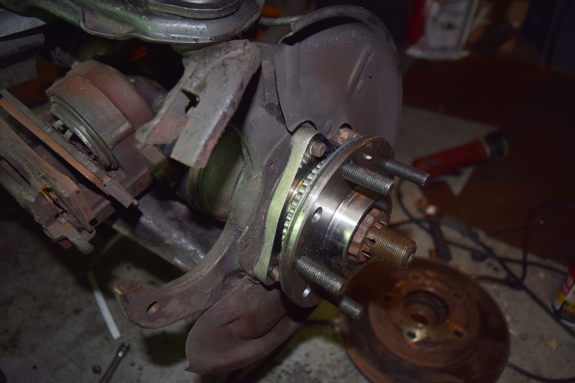

In other news ended up having to work most of the weekend so didn't accomplish much. I did finish up the new hub install on the Pass side. . . only to realize the new hub is defective, so going to have to pull it apart again and change for the other new one.
Also noticed the old hub/bearing seemed ok, so guessing it was probably the CV joint that was making noise. Will see once it's driving again.

Also, here are a few more new pics from my hub work. . that I get to do again lol. Seems to be a trend here. . .

Also, swapped out the new hub/wheel bearing assembly I had installed that was defective. Time will tell if this solved the front end noise, or if it's the axles. Most likely is the axle, but funds are a little tighter right now so I'll wait until I'm sure before ordering more parts.
