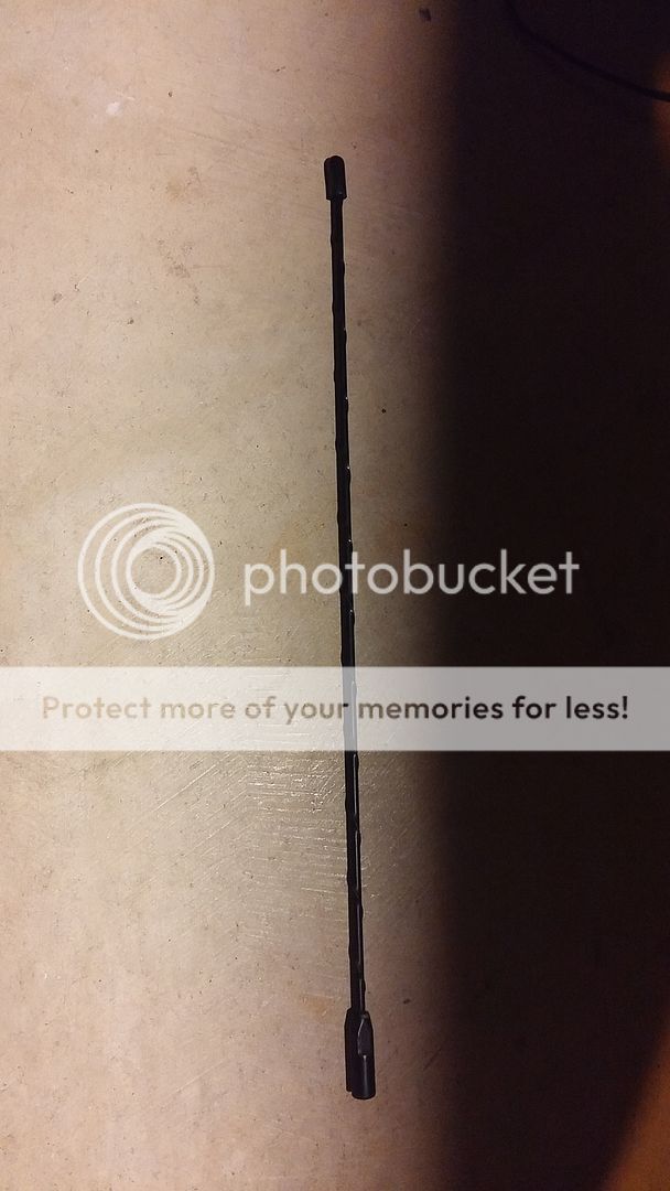

Decided to shorten my Antenna. It was a very easy mod. I just taped off the area to cut and used a dremel with a cut off wheel. then topped it off with a vacuum cap.
Doh!, I forgot to take a picture of it on the car.
