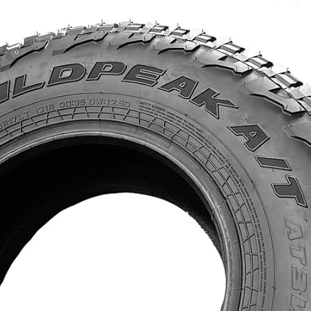

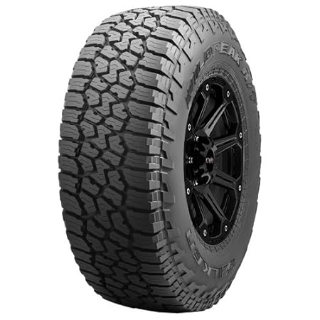

Well, my cheap Chinese tires are getting close to the wear bars. I am actually impressed with how well they ride and how great they do in the rain. However, the blazer has been useless in the snow, even in 4 LO. I also had 2 with nails in them and I don't really want to drive 4 hours to the beach with plugged tires. So I have a set of
these these
showing up on Tuesday. I was going to get Yokohama Geolanders but the price went up $30 a tire right before I ordered them. I have never run Falken tires before but these got great reviews.
