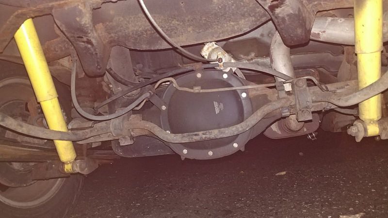

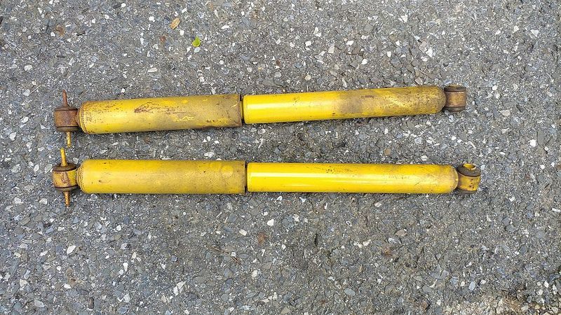

Also, my blazer has developed a seriously saggy rear end. So I grabbed a pair of
these these
guys

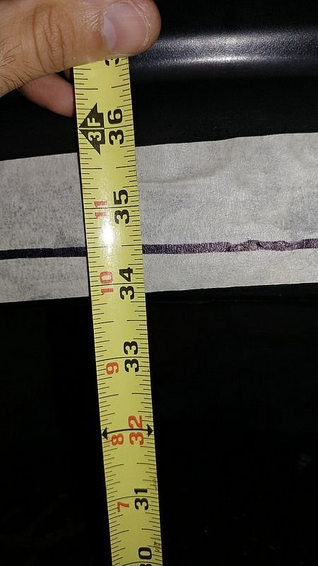

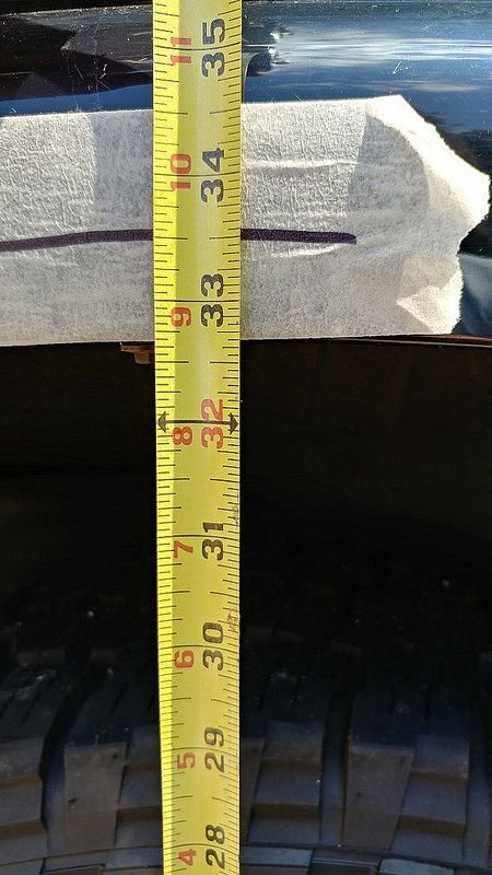

Took some ride height measurements before I installed them. My driver's side sits about 2" higher than the passenger side which may need to be addressed. It could just be that my driveway is oddly shaped.
Passenger side before & after
Driver's side before & after
The old ones were cake to get out but the new ones not so much. I had to deal with a broken speed nut which I had to use vice grips and a lot of patience to get out, then I just use a nut and bolt. Then I had to fight to get a socket around the spring. Since these do not compress easily like the other ones I had to jack the blazer up to line the shock up with the bottom mount. I still need to work out the passenger side spring hitting the exhaust but that isn't a big deal, I think I have a plan for that.
Old junk
Old junk out
New junk in
