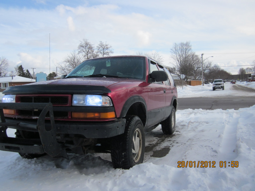

Headlights arrived today, and I got them installed in about 30 mins. Look fabulous! the 8000K has a fair tint of blue, alot more then I thought it would, but I love the look and the brightness they put out! Pics to follow real soon

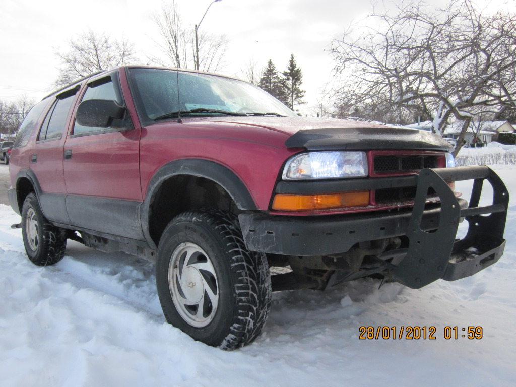

Pics + Vid
2000 Blazer 8000K HiD - YouTube
The pics are with my HiD's on, at 1pm. In the pic I have my 2" BL and stock 235/70R15's on (winter tires n rims)
-OSS

Nice! Ive had the same ones for about 2.5 years now and still love them. I hate normal halogens now

Lookin good. 8000 is really really blue. I have 6000 in my blazer, and I think they are still really blue. For the Silverado I got 4500 which is actually white, and 3500 which is a yellow/green for fogs. There is some guy I drive by every morning that has some very very green headlights, I wonder what color temp they are? They are not yellow at all.
