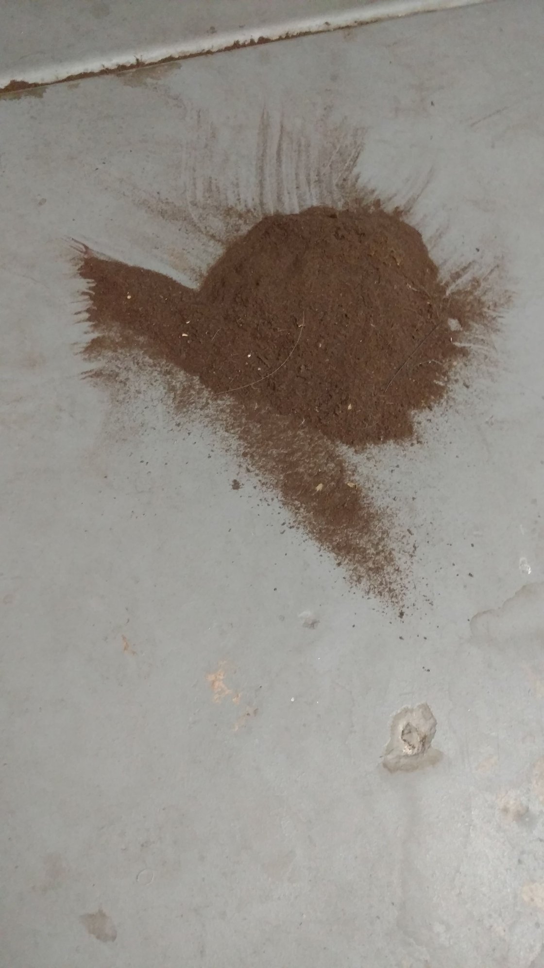

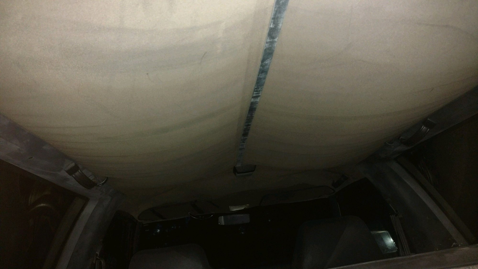

So got a few things done this weekend, the headliner fabric was sagging had a couple bars holding it up so i could see out thetback. I removed the headliner, removed the fabric and brushed off all the old foam glue and then glued the fabric back in place. Glad I'm not gonna have to do that again also found a 89 blazer for sale for 650 for spare parts car, it's only rwd so trans and drive train no use to me, but gonna help with some pieces missing here and there now have spare motor to build 😁. Spare parts blazer.
Headliner installed
All the dried up foam I brushed off the headliner board and fabrick
Headliner all brushed off halfway done
Finally got the SOB out
The fabric sagging center bar up to hold it up lol
