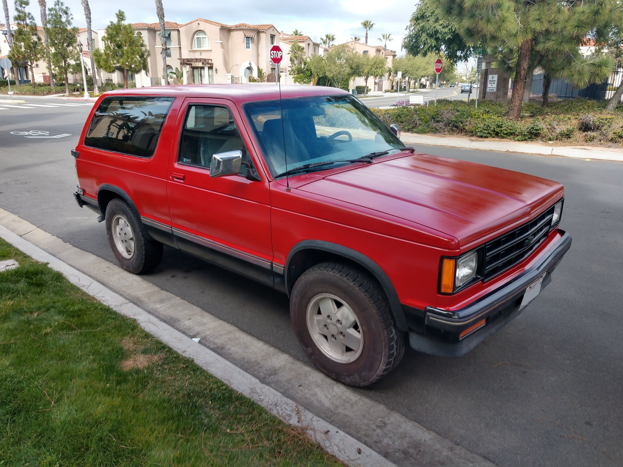

Well engine is still out, so decided there was some surface rust that needed to be taken care of this is current state, body base been completely sanded down and sprayed with primer, doing it two tone the bottom tone is done all that's left is the top Wich will be red

Nice work so far, following.

Looks good... nice and fresh lol

She needs a bath, and a deep cleaning.

Damn she looks good!
