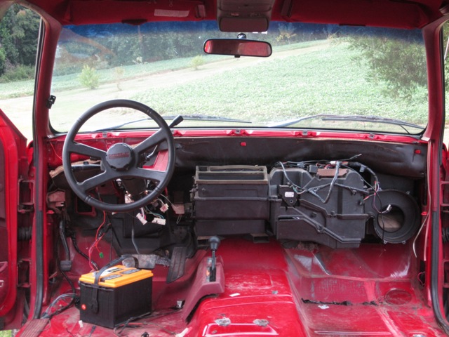

With the help of a friend, a few large cans of red bull, and motivational music blasting....for the entire dash and heating/ac unit removal took about 2.5 hours.
I will not be using the factory heater or AC. I will be using the AC compressor for a on-board air compressor conversion, and for heat I will be using a Maradyne Stoker Heater. The unit is only 7.5" H x 11.5" L x 8.7" D, compared to the original one (see attached photo).
