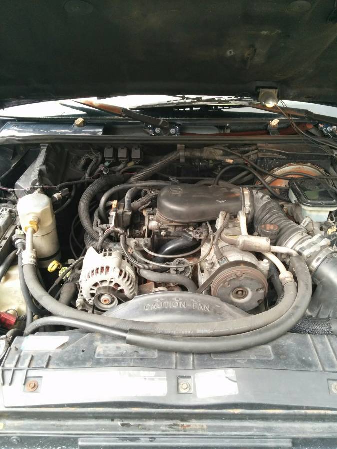

While tinkering with the front axle actuator; I think I got 4Hi working but I needed to see my 2Hi start point so I grabbed a few little light bulbs from the three button switches in other GMs in the same configuration. The button lit up as soon as I turned the key! In 2wd I left a single long rip in the grass along a side road. In 4wHi I could barely spin them so I went to 4WLow. I pegged it up to the red line and left double rips but I don’t know if the open rear end hooked up or one rear and one front. I’ll have to do it under adult supervision next time to see it from outside the truck. This little Hot-Roding event blew my water pump. Spraying all over the intake manifold. I wasn’t sure if the temp gauge was stuck to go no higher than 180 until now. It’s kind of a critical item so no salvage parts this time. I cannot believe how incredibly easy it was to change this pump. Maybe I have been working on fords and Jeeps too long. Glad to be back in a GM !
Funny thing. 80% of the replacement pumps are sold with a new fan clutch. You almost have to special order just the pump. I just followed the trend but now I think the clutch is working 100% of the time. When the engine is cold I can hear that fan roaring. I gotta get to the bottom of that.
Next stop was the muffler shop. I wanted a nice rumble without any “teeny bopper” noise so I took it to the next county where a family member runs a shop just for mufflers and cats. He warned me that any V-6 is not ever gonna sound like my V-8 Mustang; but said it could sound pretty good. To keep it from sounding like a pissed off bumble bee in a snare drum he recommended an insulated free flow muffler by magniflow. The model was “Thunderbolt” and was designed for V-6s. I have to admit; at idle you really can’t even hear it. When scooting around town it has a nice sporty sound.
They cut the cat all the way to the tail pipe out. Turns out, the guts of the cat had disintegrated into tiny chunks that were clogging up the original 4’ muffler. Now I have a neat, clean pipe with no cat and a much smaller muffler. Overall, I would say it feels quicker and sounds pretty cool too.
